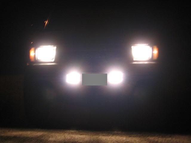

I put some 55w driving lights on my truck a while back, and I'm trying to figure out if it'd be possible to keep the switch for them in the truck but have a relay hooked up so if I turn the brights on they'll turn off?
I'm pretty sure that's the only way it's legal to use them on the road in Va..
I've searched but haven't found anything about keeping the switch along with a relay.
what I've got is the red power wire coming from the battery to the switch, and green wire from the switch to the lights. Can I put a relay in the green wire and hook it up to the bright wire to have it cut them off that way?

yeah that's how mine are now, but if I use my brights they stay on which as far as I know is illegal in va.
anyone know if there's such a thing as a relay that opens when power's sent to it? that's what I need..

I have them aimed to shine a little bit past what the dims do, but that's what driving lights are supposed to do anyway.. This guy driving a big chevy kept flashing his brights on and off till he passed me tonight, but that's the frist time anyone's flashed me for having them on.

I always thought driving lights were supposed to come on with your high beams? No wonder the chevy was flashing at you. You already said the driving lights were aimed higher than your low beams, so there's no relief for people coming the other way.

Well as far as I know va law requires any auxiliary lighting to shut off with bright lights. And they're not even aimed as high as the instructions say to aim them. Have you ever seen a picture of how driving lights shine past what the headlights do? it doesn't mean they're aimed higher, but that they're a more concentrated beam that doesn't give off any light to the sides like fog lights.
