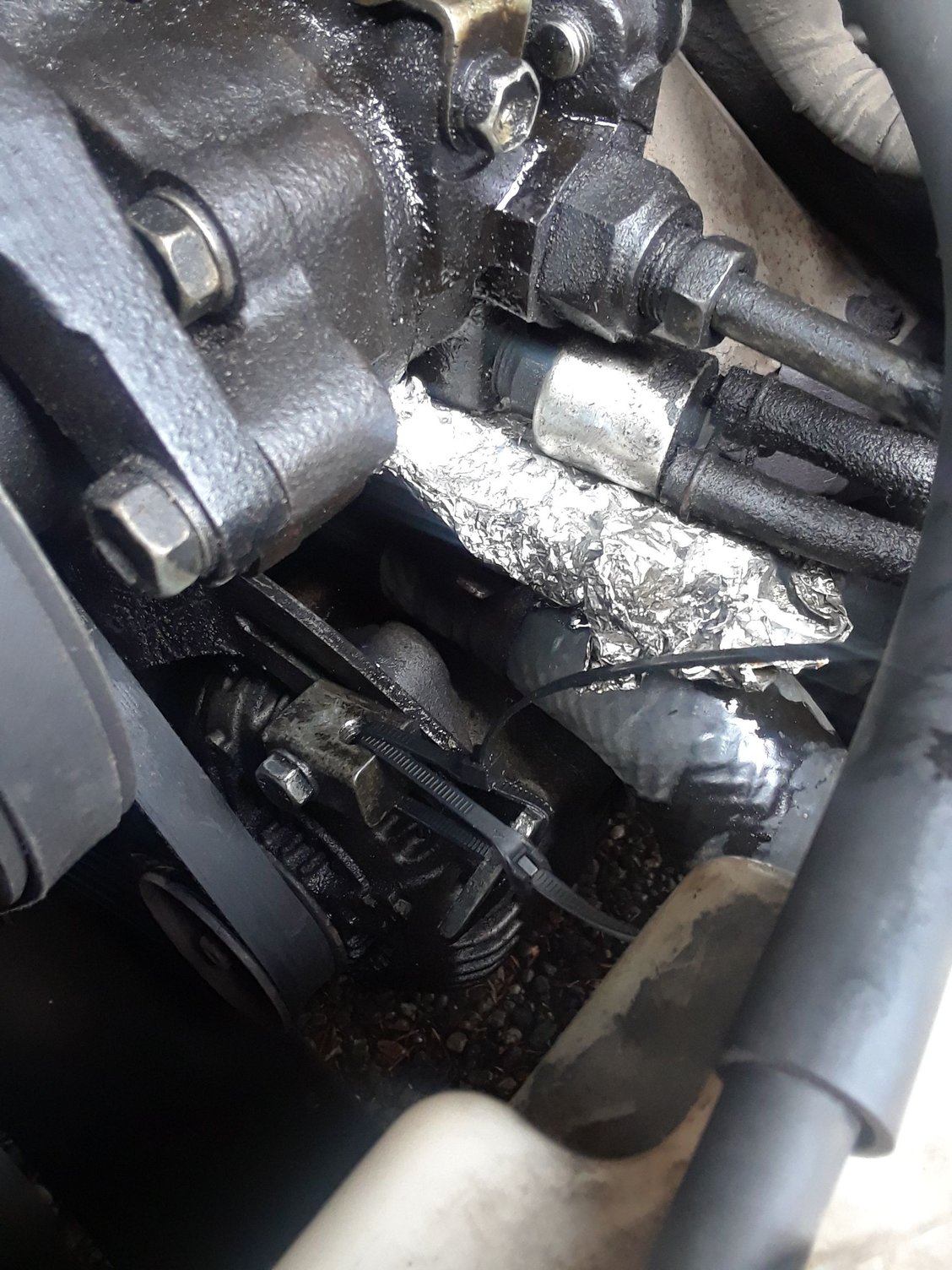

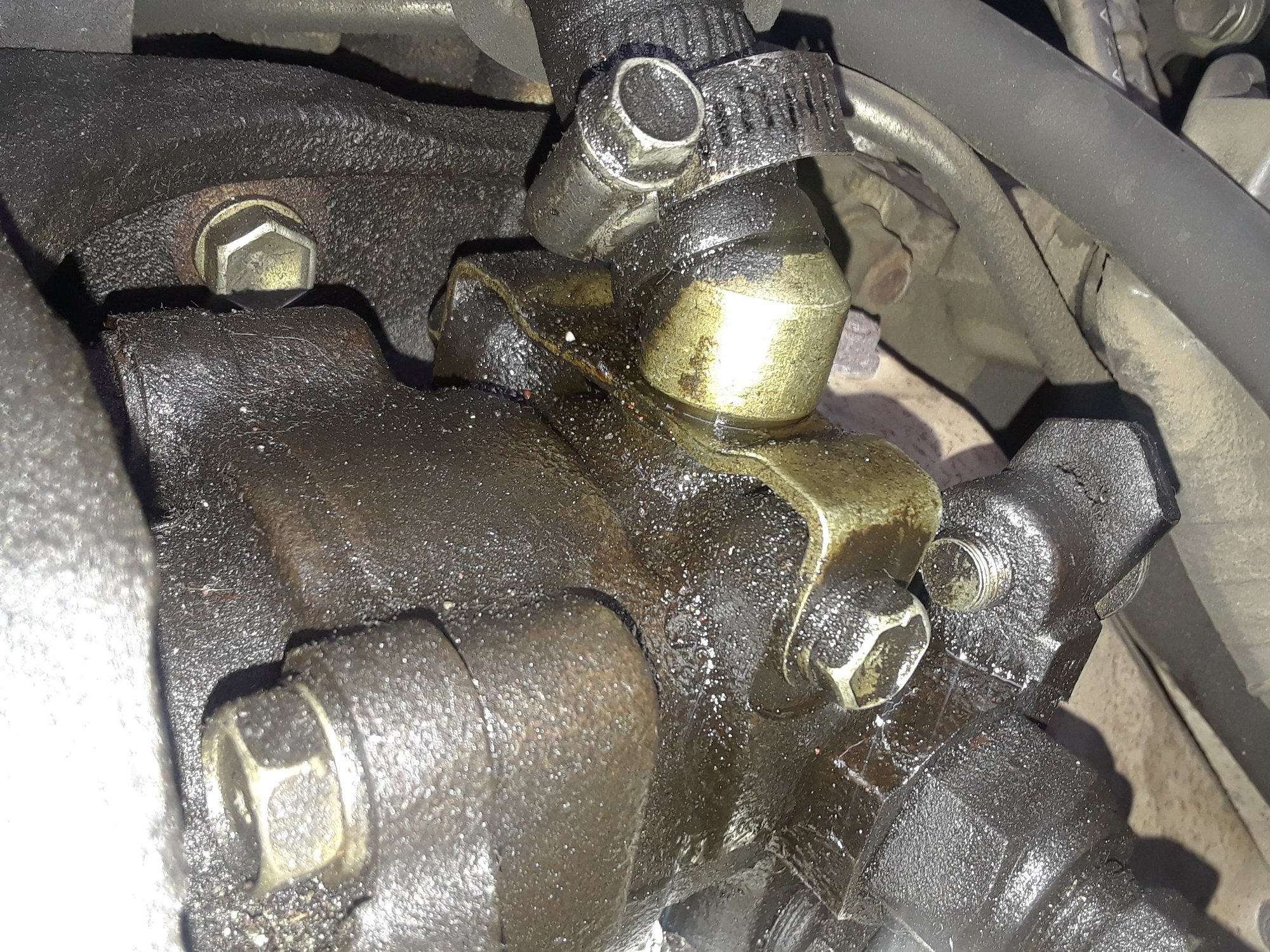

Also, the alternator had an issue with the power steering fluid leaking into it from a damaged gasket. I built a foil shield for it to divert any leaks until I can repair the seal. That was quite some time ago, around the time that it stopped However, I also tightened the alternator down with zip ties, as the alternator housing is stripped and I need to take the radiator hose off to add a longer bolt/nut. Now the belt tension is much better.

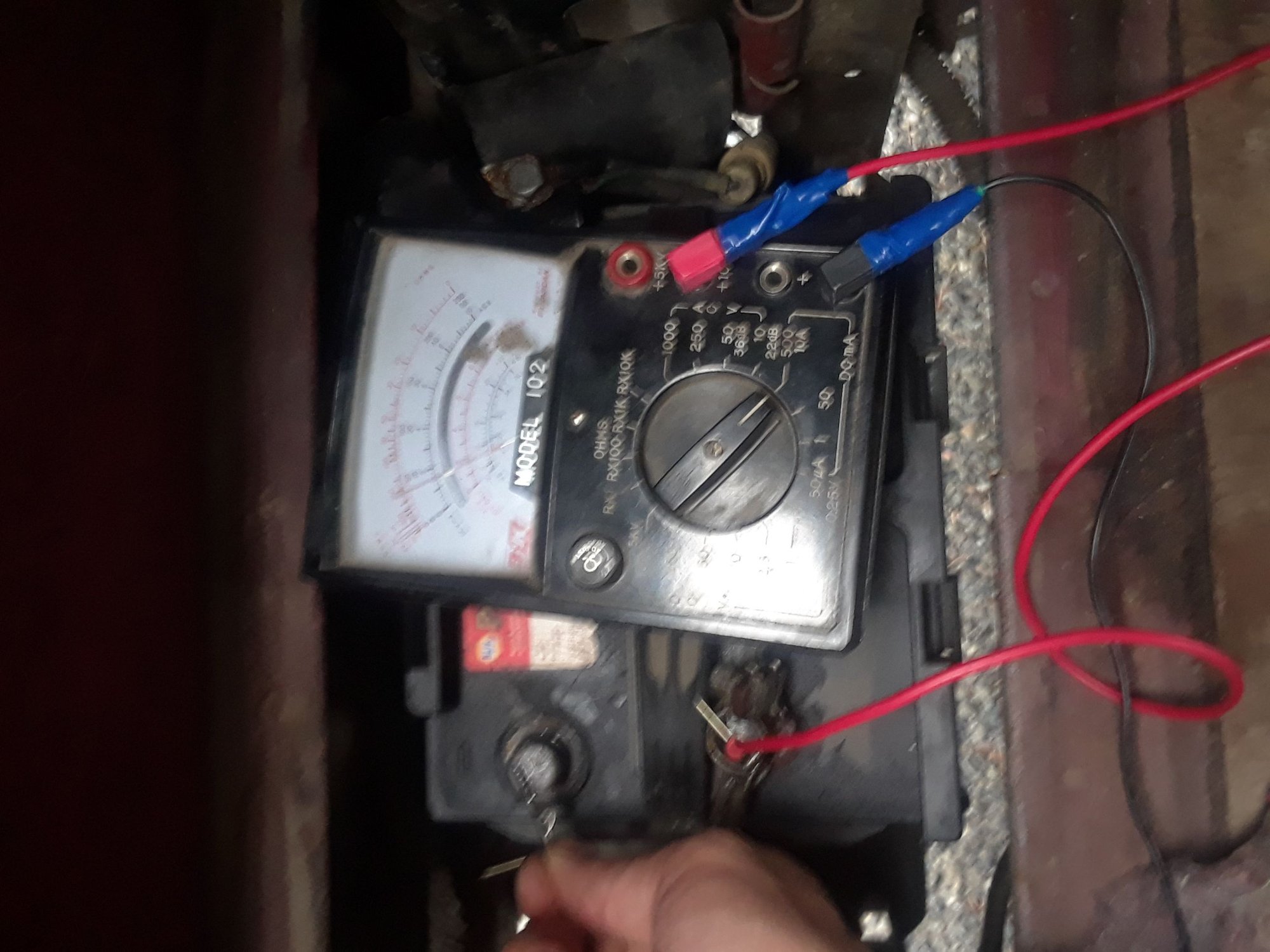

Got a new meter. Vintage from the goodwill bins, paid $1.34/lb for it, so maybe $2 max. Plus I had some spare leads I was able to hack into it. My other meter's current functions are completely shot. This one suggest a larger draw than previously anticipated. 1.4A if i'm reading it correctly (the bottom line of the upper black scale). The power died really quickly today when I went to the store for a few moments. I did leave the lights on for about 10 mintues while in the first store but it wasn't starting by the time I was out of the second, ~20-30 minutes max without driving. So for now I'm going always disconnect the negative wire whenever not driving it.
For fun I've posted the engine bay and alternator. Its a PIA to get to a lot of the stuff on here. Today was just getting the new meter working, I'll disconnect the alternator in the next few days when i have a better place to work on it. The weather started to turn right when I went out today. I'll also work on getting that meter hooked up so that I can see whats happening when I drive. The battery box is behind my seat so its just a matter of getting longer wires.
