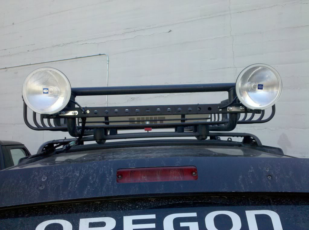

I have two Hella 500's coming off the back of my rack.

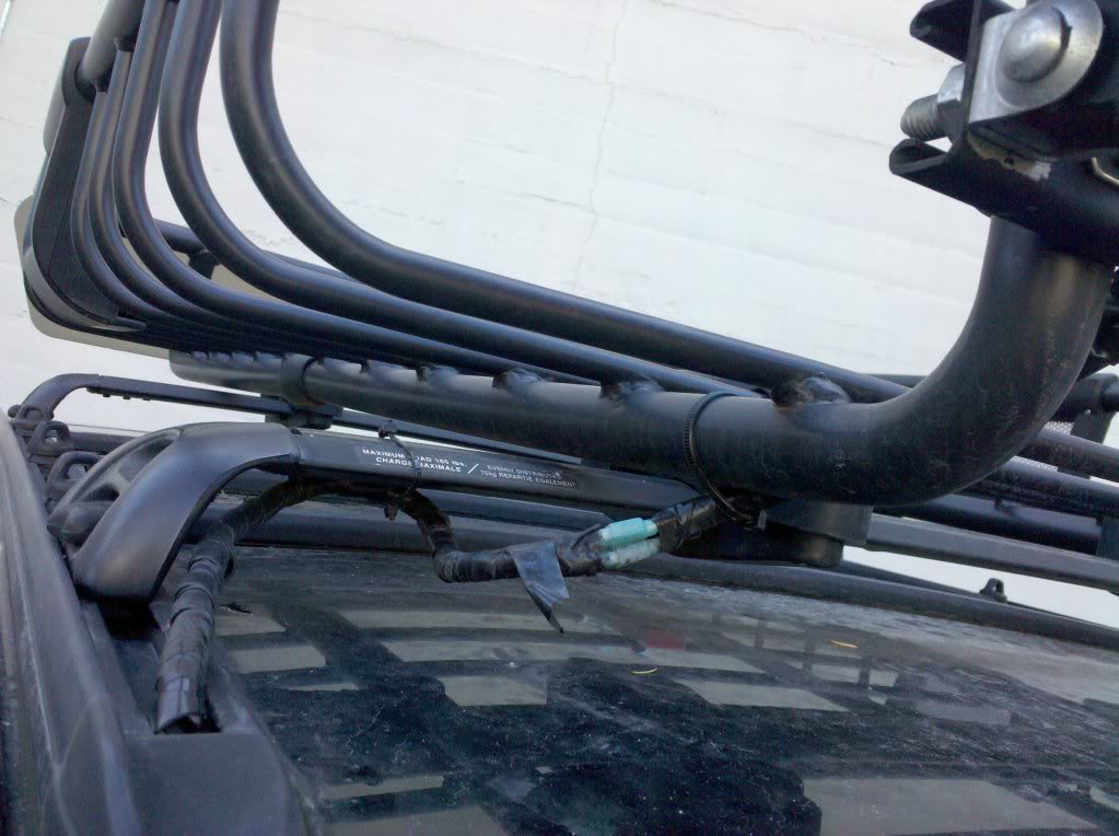

I ran the wires down the rack and across the factory rack to the rail (I need to get a nice weatherproof plug to replace the wire connectors but that's besides the point).

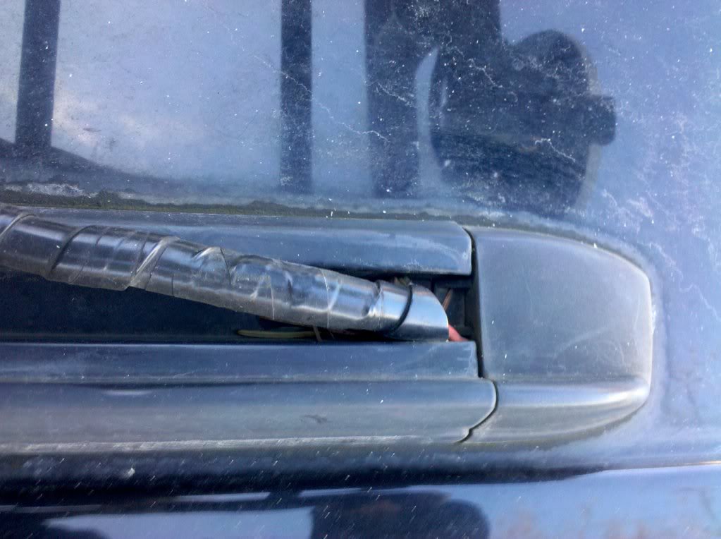

I drilled a hole through the back of the end cap on the factory rail and drilled a hole through the drain plug that is located underneath the factory end cap.
Then I ran my wires through the drain plug and along the headliner, down the side pillar, along the floor board and through the firewall and wired up the relay and everything under the hood. After you run all the wires and have everything zip tied off put some silicone in the drain plug all around the wires so that no water can get in there. I've had mine wired up for over a year now and haven't had any issues with water leaking or anything.
I got the idea on this site somewhere, so there should be a thread with a full write up somewhere.

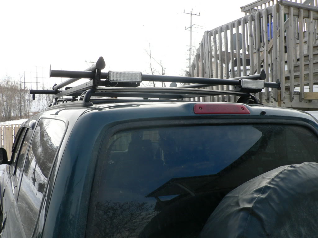

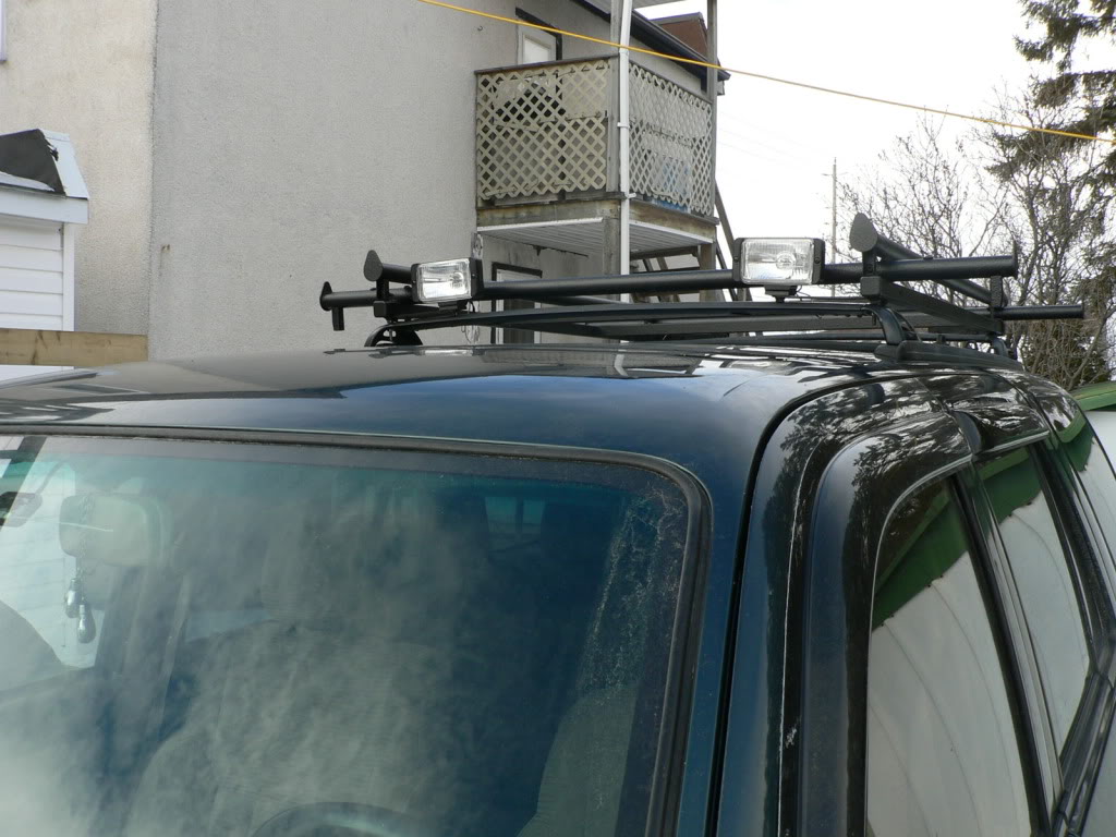

Well, as many of you might know, I've built myself a roof rack out of discarded retail racks. I've mounted the lights to it, and now waiting to run the wiring through the roof, and down the headliner. I've got driving lights in the back, and back-up lights in the back which will be tied into the stock back-up lights.
What do you guys think?
