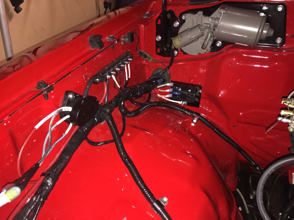

Just a FYI, last night I wired up my constant power fuse block that I was telling you about earlier.
From left to right:
1 - Power (+) Distribution block - 6ga wire lead from the battery then power is disbursed to 3 fusible links (Factory circuits) and to a 12ga wire to the constant power fuse block (Accessory add-on circuits).
2 - Ground (-) Bus Bar - 6ga wire from the battery then ground wires can be grounded in one central location (not a good idea to ground accessories here that would be sensitive to interference and ground noise)
3 - Constant power fuse block - feeds accessories like an auxiliary 12v cig outlet, fog light switch, low draw lighting, etc.
I actually have two of these fuse blocks. When I originally went through my wiring harness during my restoration I added an fuse block with ignition source power, but I neglected to wire in a fuse block for a constant power source. It was much more difficult to run the wiring as an after thought, but I got it done so now wiring any future accessories will be a breeze. No inline fuses, not splicing wires, no toning out power sources, no birds nest of wires everywhere. I too will soon be adding fog lights so this is where I will get my 12v constant power from to the relay for the lights.
