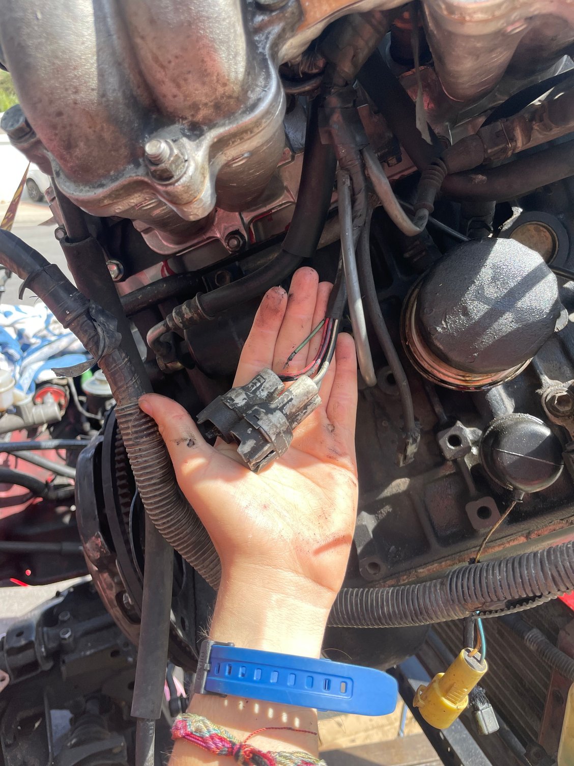

Hey guys I was hoping for a little help as I’m rebuilding my engine and it’s come to my attention a lot of electrical is loose or disconnected entirely like this:

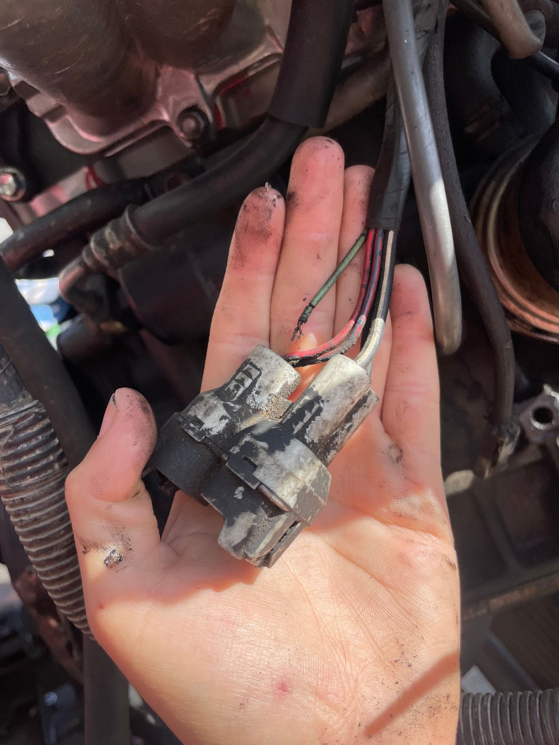

I was hoping to get an identification on the green wire specifically and maybe a solution as to finding a proper connector plug to re attach whatever it came off of!

I think, although very rarely, that the green wire connects to the 4WD indicator light on the dash. I believe the other side of it is coming out of the transmission. It comes out on the drivers side,goes up and over the tranny, and connects to the plug you've got there. That's the way my 87 4Runner was.
To the best of my knowledge, the other side isn't used. At least not on a manual transmission. I've never even owned an auto transmission vehicle.
