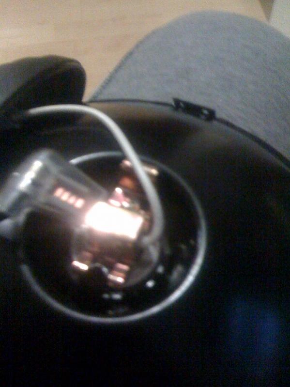

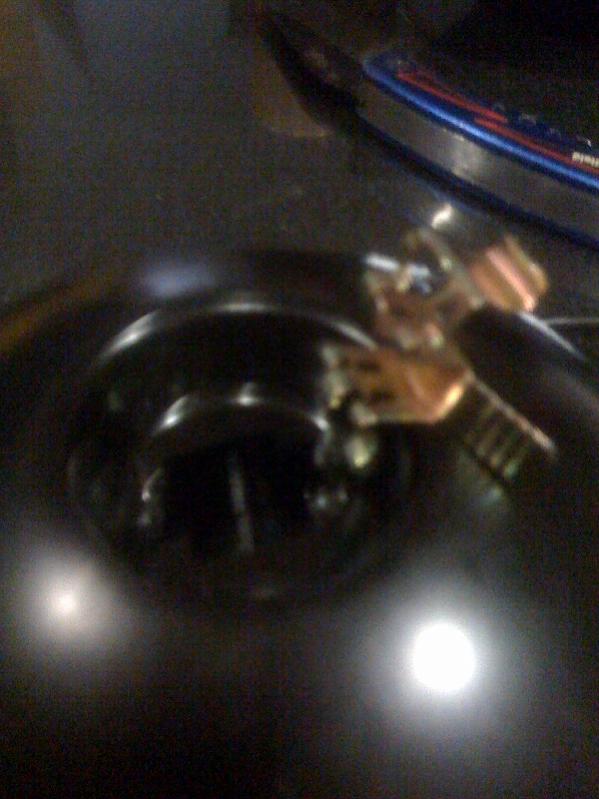

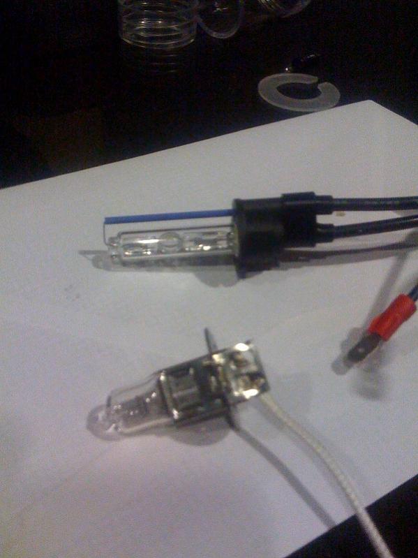

What the heck is wrong with my Hella 500's..?
I just got my Hellas in teh mail today and the backing is different than yours, it is a latch that clips over the H-3 bulb. The HID bulb will not fit....
Did Hella switch to a different type of latch or what....?
Attached Thumbnails HID's in Hella 500's Write up with LOTS of pictures-photo-9-.jpg   HID's in Hella 500's Write up with LOTS of pictures-photo-10-.jpg   HID's in Hella 500's Write up with LOTS of pictures-photo-11-.jpg

Hi Sorry for not responding sooner as I was out of town for spring break.
As to your question the hellas you bought i believe are the old design (I think). 2 out of the 4 hellas that i HIDed are like the ones you are having issues with so you CAN make it work. You can either find the retaining clip from the other style hella used and adapt it to your version or you can get a piece of wire and wrap it around the HID bulb and the clips on the base of the hella light where the retaining clip connects to. Hope that made sense.
