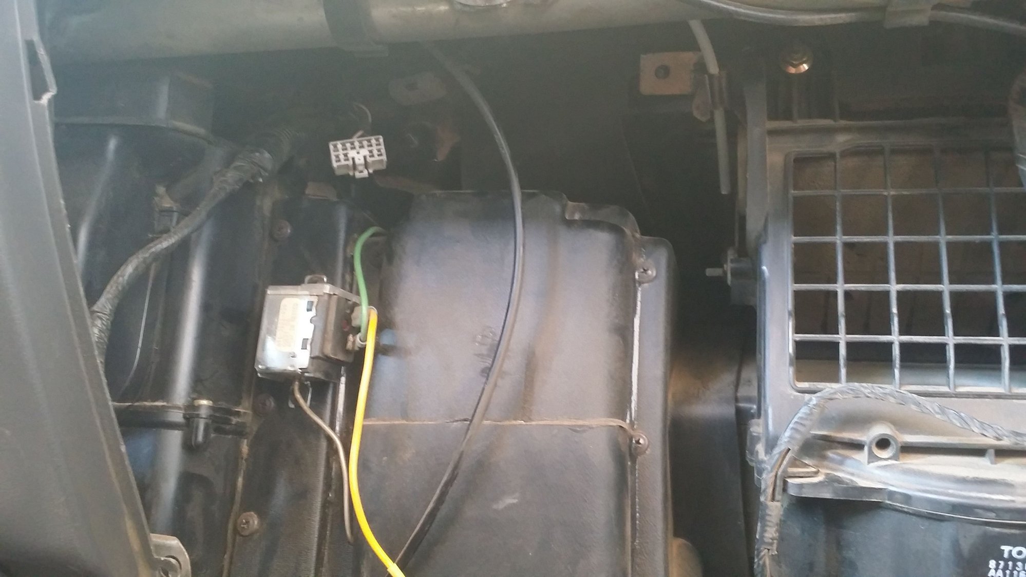

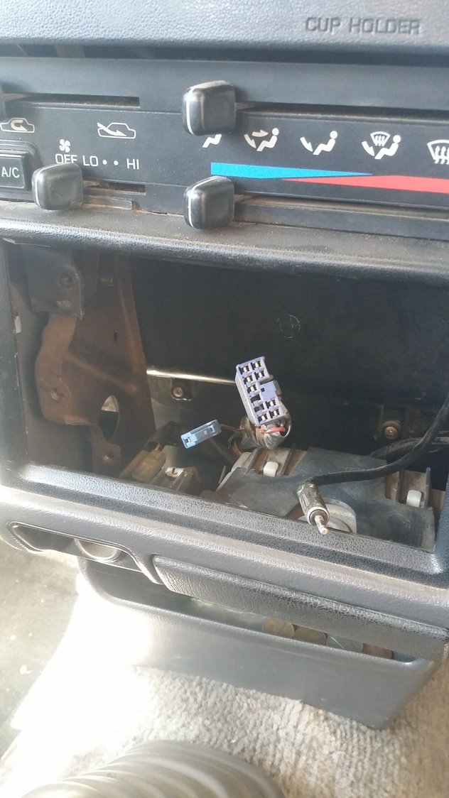

Coming from the back. What are these connections? Are these connections accross the board standard, or do I need a special stereo to connect to these? This is from behind the glove box.
What is the small box with a green and yellow wire?

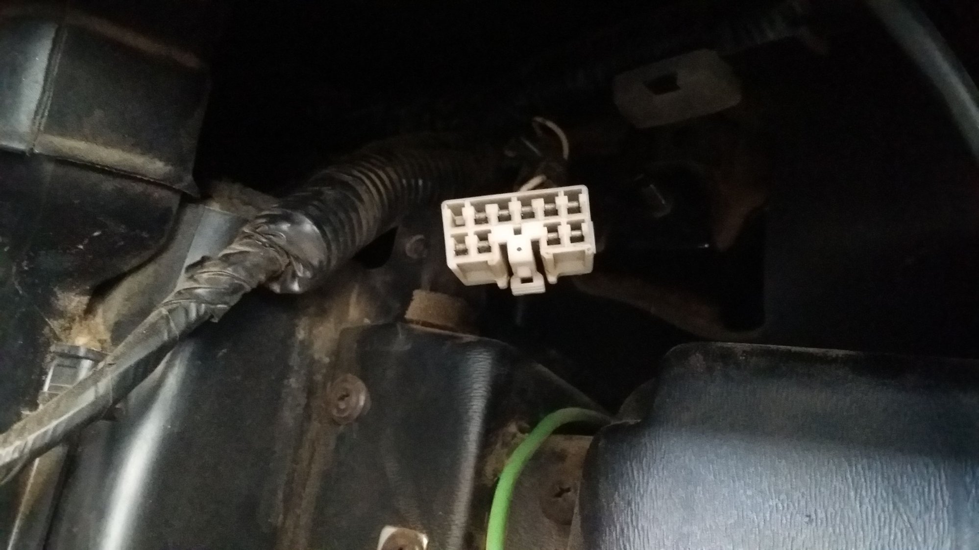

I assume the white connector in the top left is for an amplifier? Do I need one of these?
Close up of white connector.

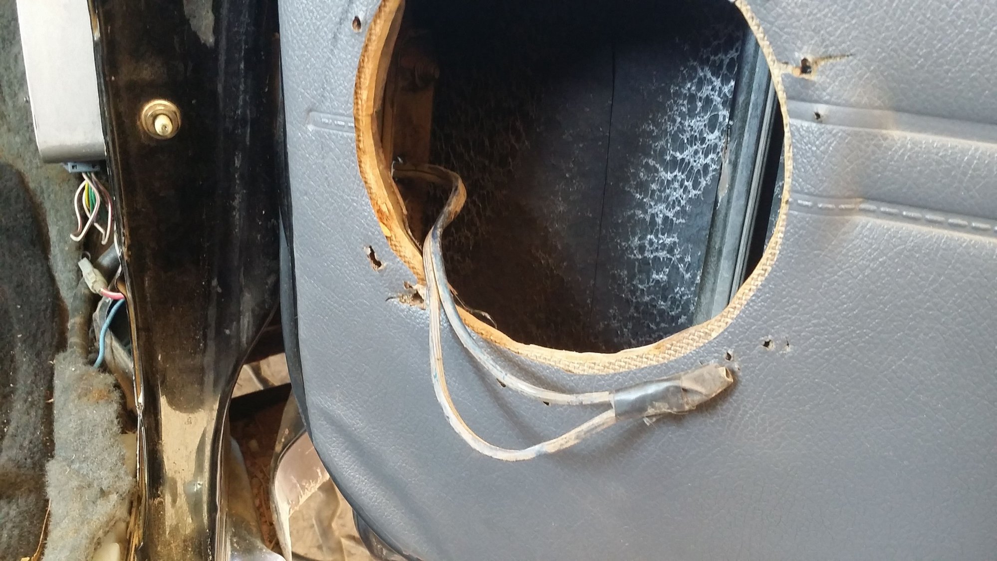

The speaker wires

Tip #1 DO NOT cut the original stereo plug off of the harness to wire in an aftermarket stereo! spend the extra few bucks to get the pigtail that plugs into it. This will allow you to do all of your splicing on a workbench and not with both hands crammed into the stereo pocket.
Tip #2 If you solder all of your connections you will never have to mess with them again.
Tip #3 Do it right the first time, don't go cheap, choose a quality brand name. They will last longer and you will be more satisfied with the sound and operation. Just pick something with the features you want with easy controls that will fit in the hole. Same with speakers, if you will be playing loud music you need decent speakers or you will blow them out quickly.
