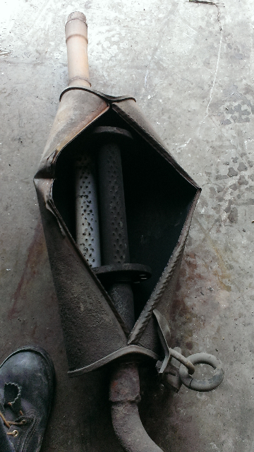

So, the short in the system is gone. I've driven it extensively yesterday and this morning without any issues. I also put a new muffler on today too. Here is my old one after the backfire.

Your last post confirmed my original suspicions, I would have said ground also, if not the ignition switch. I would still suggest looking into building a proper starter relay circuit, I was having similar grounding problems, then fixed them only to immediately have my ignition switch go out. Stock wiring sends too much amperage through the ignition switch to the starter solenoid, it's a relatively simple mod to add a 30 amp relay to the circuit, and will extend the life of your current and all future ignition switches.
On a side note; holy backfire bombs batman!!!! Never seen stock exhaust 'splode like that without a SERIOUS cat or tail pipe plug issue!

I actually added in that 30 amp relay a few days ago just to be safe. No problems since, if you look at the crease on the left side next to my foot, that is where it wrapped around my spring mount.
