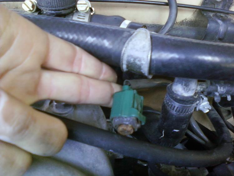

howdy everyone. i hope someone can help me with this. my 3vze is throwing a cel 22(coolant temp sensor signal) so i went to check the coolant temperature sensor and noticed that the sensor right next to it was broken in half and i coudlnt figure out what it was. the truck runs fine only the cel comes on. and even the temp gauge in the console still works. if i knew what it was called i could replace it.

that would be the ect sensor.... the one next to it prolly was the csi timer....

http://personal.utulsa.edu/~nathan-b...94electron.pdf

very awesome it turns out to the be the start injector time switch thats for the pic. i searched for a good hour looking for something like that, but didnt know the name of what i was looking for. now the fun part is getting the other piece of the old one out. thanks again
