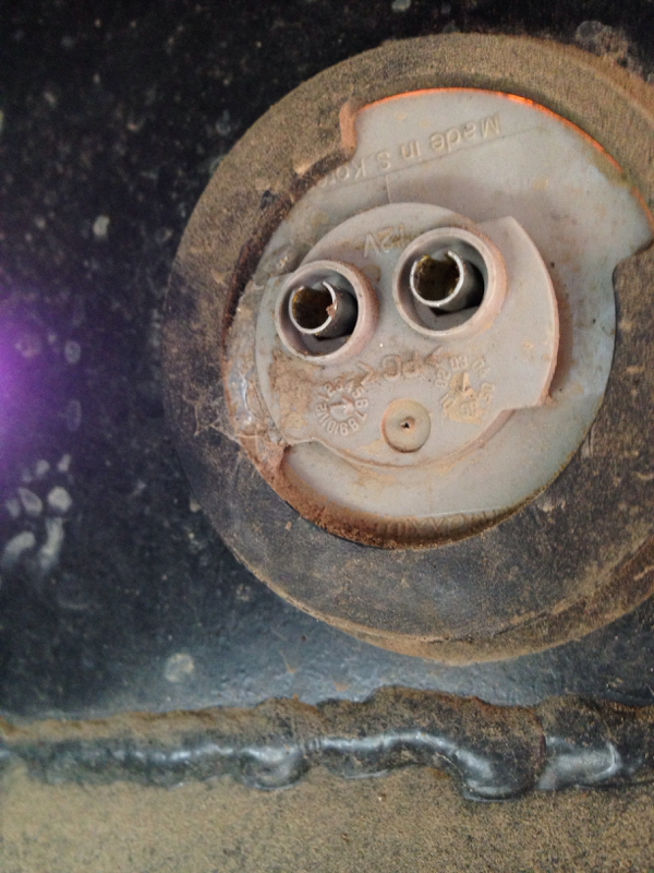

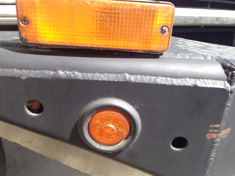

I bought a plate bumper for my 86 runner, it has flush mounted turn signals but no wiring. Does anyone know what this connection style is called? It may be very common but I know very little about lighting. In the meantime I "mounted" my old turn signals to the bumper via industrial strength Velcro :hillbilly:

Looks like bullet terminals might work.

It is a common light connection for sealed beam lights.
Most any auto parts should have them.
Maybe not Auto Zone or Advanced auto or others like this Napa for sure
it has the plug on one end and the two wires on the other.
Grote # 67050-5

I've seen the LED version of those on big trucks, they are very bright. Nice bumper, can we see more of it?

It's a standard truck side marker light. You can get replacement pigtails at any large truck
shop.
