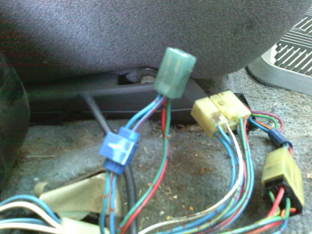

I can't find my switch, but I'll walk you through what I did to figure it out, and it worked.
Carefully open the switch. I think I used two butter knives, one on each side. When you have the switch open, you will see the connections. IIRC, there are 2 wires in the middle (centered below the button) and 2 on the outside. It's the 2 wires in the middle that you want to tap together.
The reason you have to open up the switch is to discover which 2 wires are the magical ones. Then, make sure you find the corresponding wires on the vehicle end of the harness and tap them together.
WAIT. I have a pic in my build-thread, let me go find it.

THE BLUES! ITS THE BLUES!!!
Tap the 2 blue wires together. I'll post a pic in just a sec.

And if that little group of wires are still too much of an obstruction, cut the 2 blues short, solder them, and just cut down the red and green.

Thanks B4! That's most helpful! I figured those two went together I just wasn't quite sure what to do with the others
