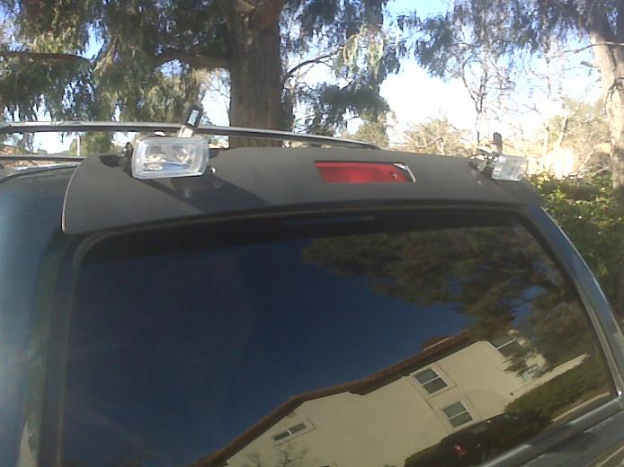

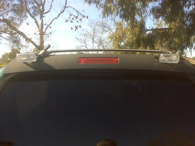

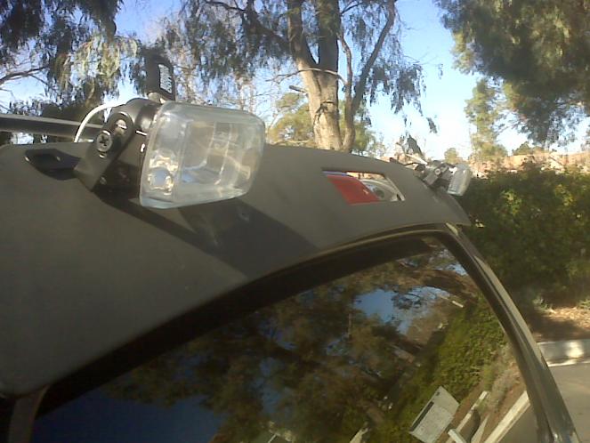

Been thinking about doing this and haven't seen anyone else do it...but I picked up some $20 fog lights from Wally World....they are just clamped to the rear deflector right here, but this is what I think I'm gonna try...

I have something similar on the headache rack on my truck. they work pretty good

I did something similar, I had a low profile driving light that I wired up with an old relay, I had to run a wire from the battery to the back to feed the relay clean power then just tapped into my passenger side reverse light + and was good to go, though the cheap wal-mart light eventually crapped out and when I put the new bed on I cut all the wire out and put it back to stock but with the camper shell on with its tinted windows that light was crazy bright for backing up at night!
