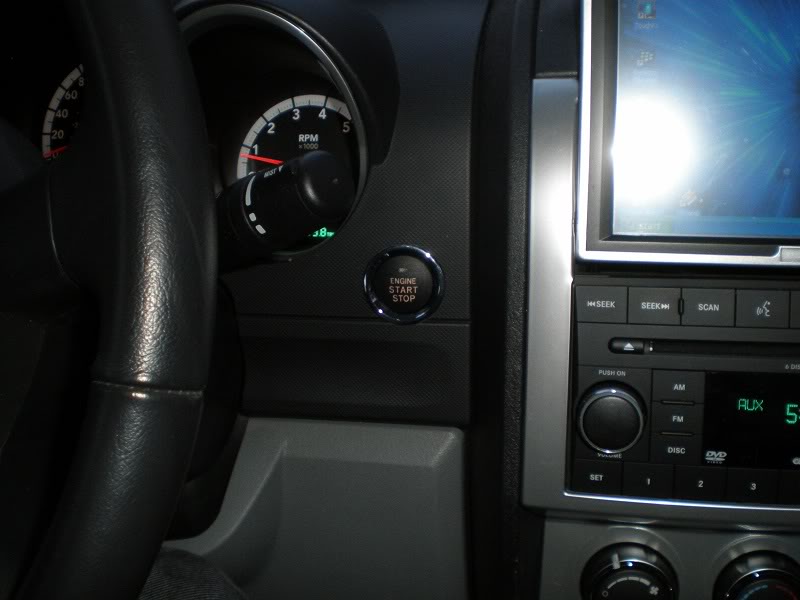

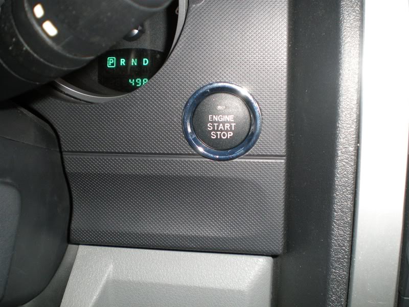

Here are a couple pictures of it installed, video to come soon:
Push Button
Alarm LED
Remote, back-up RFID credit card remote.
