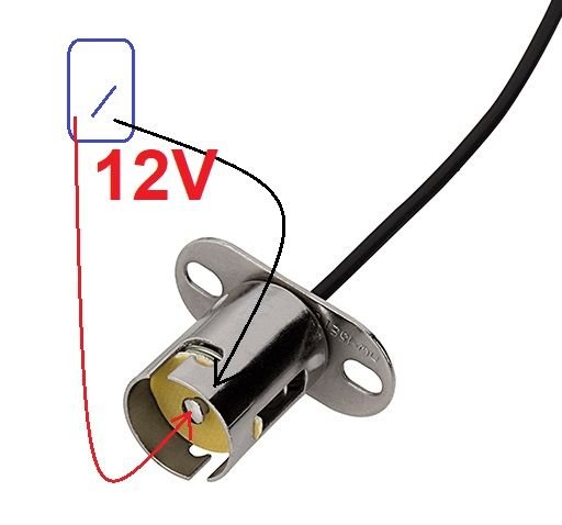

You said "No tail lights". How about front markers?
Measure voltage between wire to middle pin of connector and the outer metal cylinder. Should be 12V.
If you don't see 12V, keep red probe (positive) on middle contact. Move black probe to absolutely known good ground (i.e., ground of brake light). Should get 12V.. Then you know there's a break between ground and the outer metal cylinder of socket.
