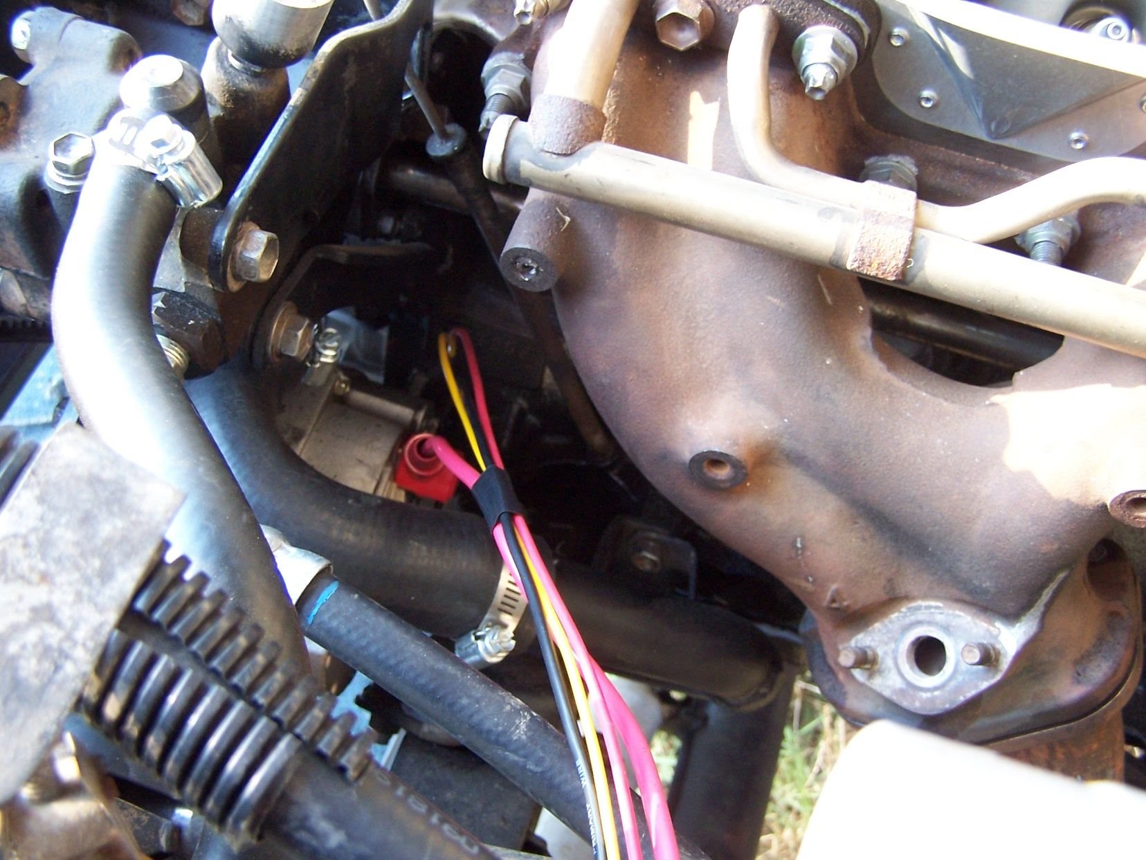

I did the upgrade on my 86 with a GM alternator. Liked it and did it again to my 84. The wiring was a bit tricky until I figured out how to do it cleanly. After that it was a cake walk

It can be a 1 wire, but you have to rev it over (I think) about 12-1500 rpm to kick it off. It won't take off at idle and charge. The small red wire is a sensing wire (not always needed, usually looped to the alt/batt post on the alt), the yellow is from the toyota ignition to start it charging at idle (factory) also makes sure to turn off the batt light in the dash, the black wire is a ground (not always needed, but I was just being cautious) and the large red is alt to batt.
