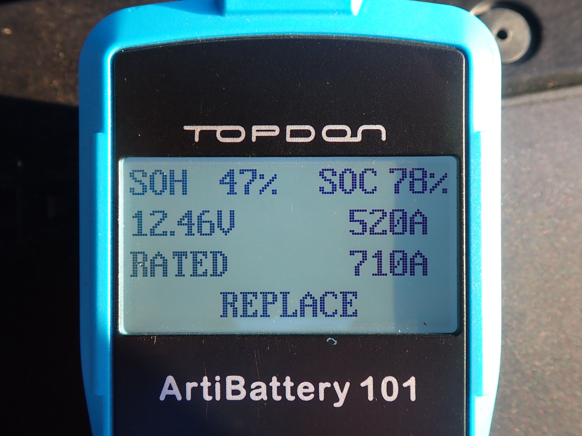

Hey guys,
I recently started using a battery diag tool, and am deciding if a battery replacement is needed in my '18 SR5 4x4 Tundra. Even in a hot environment, I've always gotten 5-7 years out of a factory Toyota battery, but according to my diag tool, the factory battery already needs replacement. It was tested, then charged with a 5 stage desulfating charging. Whether or not it tested as "good battery-recharge", or "replace", depended on whether I selected "before charge", or "after charge". So, I waited a couple of days for the charge to settle, and tested again this am at the overnight low temp of ~32 degrees. The results are in the pic below. The truck seems to start fine, as it always has. I may be worth mentioning that I have also tested and topped up several lead acid batteries, with otherwise predictable results (one other lead acid battery, stored for years, was bad as expected, 3 others tested OK). I'm not one to wait until failure to replace something like a battery. What say you, and which replacement would you choose today (and why).
Old Jan 12, 2021 | 06:35 AM
Tacotex's Avatar
Joined: Dec 2004
Posts: 213
From: Houston, TX
BTW, selections on the tool were:
In vehicle
Regular flooded
Before charge
710 CCA
The battery is made by Johnson Control, USA
Start and charge tests were "normal".

Wound up replacing with $325 Odyssey "performance" AGM, after learning that Wal-Mart (Everstart Maxx) does not carry the 27F size for the Tundra. Used to be a Optima guy, until Johnson Control moved production from USA to Mexico, and ditched the quality Optima batteries once had.
