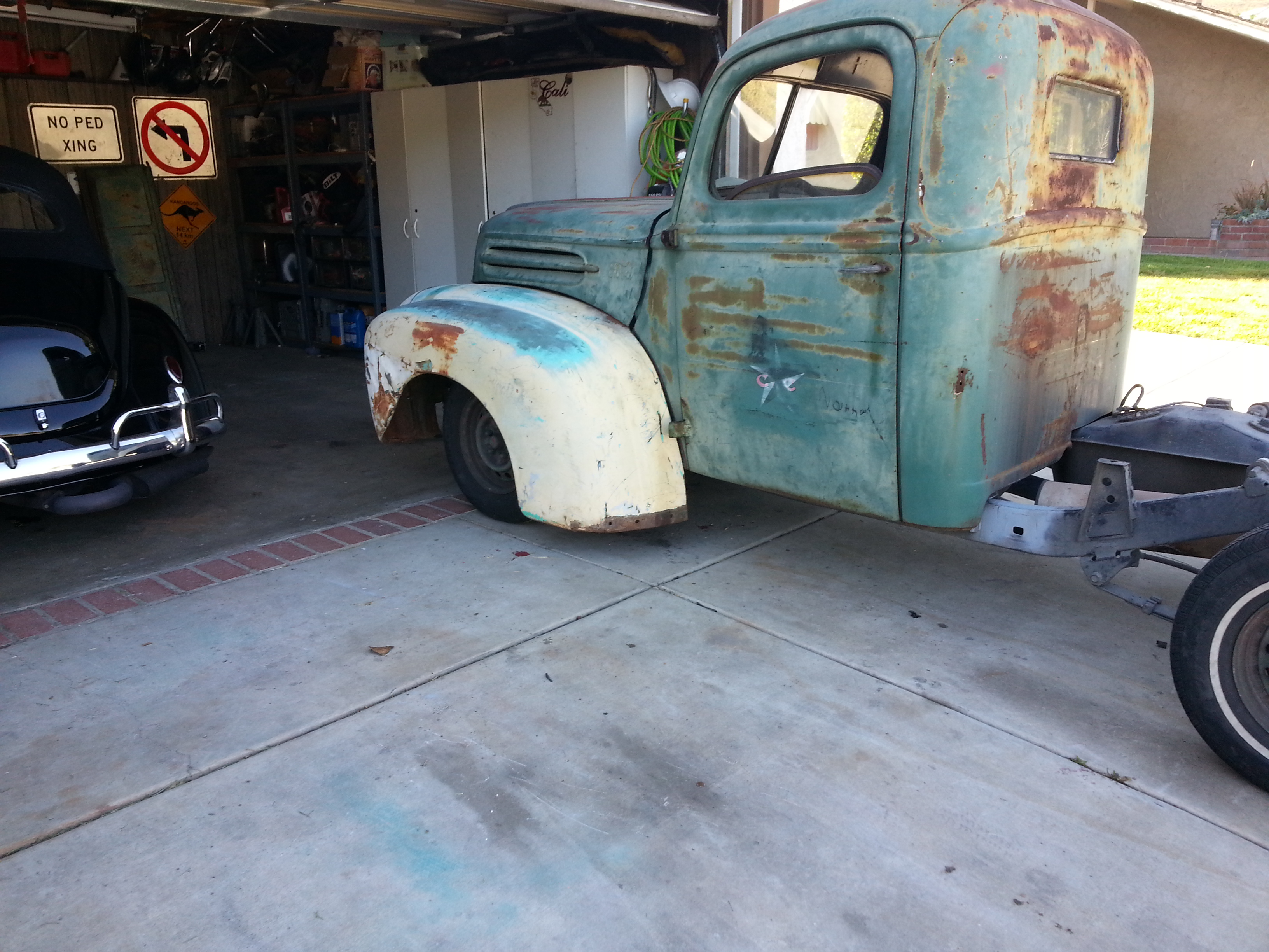

Heres the truck
Attached Thumbnails 1993 Toyota truck to 1947 Ford no brake lights-20150419_164957.jpg   1993 Toyota truck to 1947 Ford no brake lights-20150419_165019.jpg
