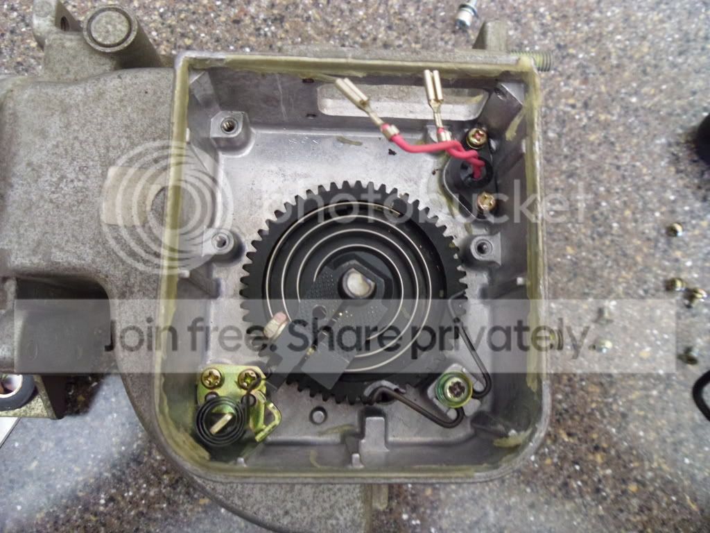

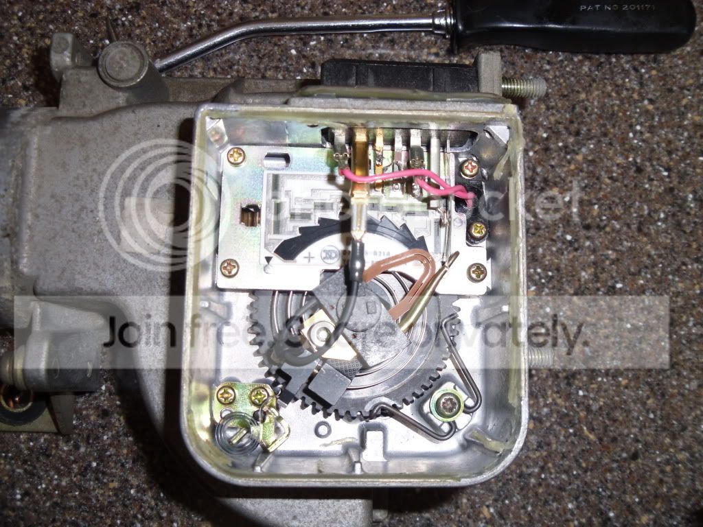

Here is a picture of the inside of the AFM...Pretty old school technology which makes this swap easy. Check out the two pinkish/red wires and the single black wire with quick connect spade terminals.

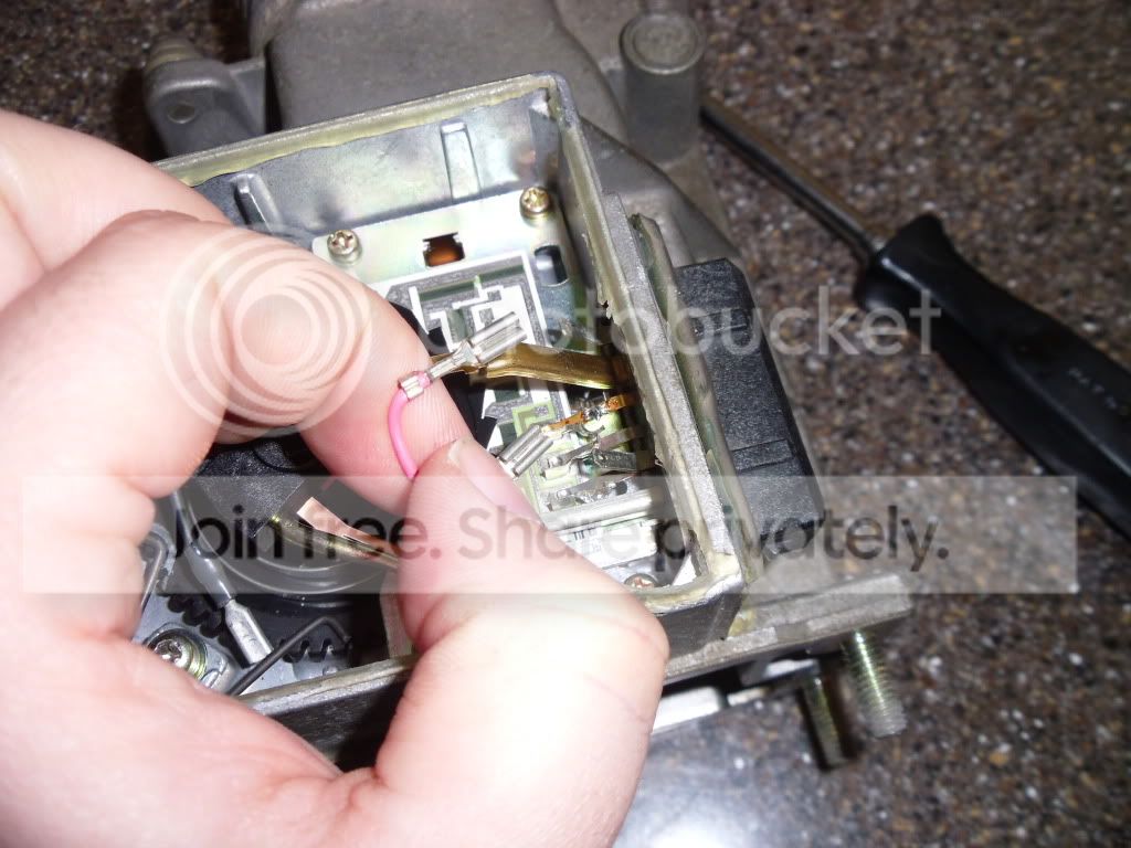

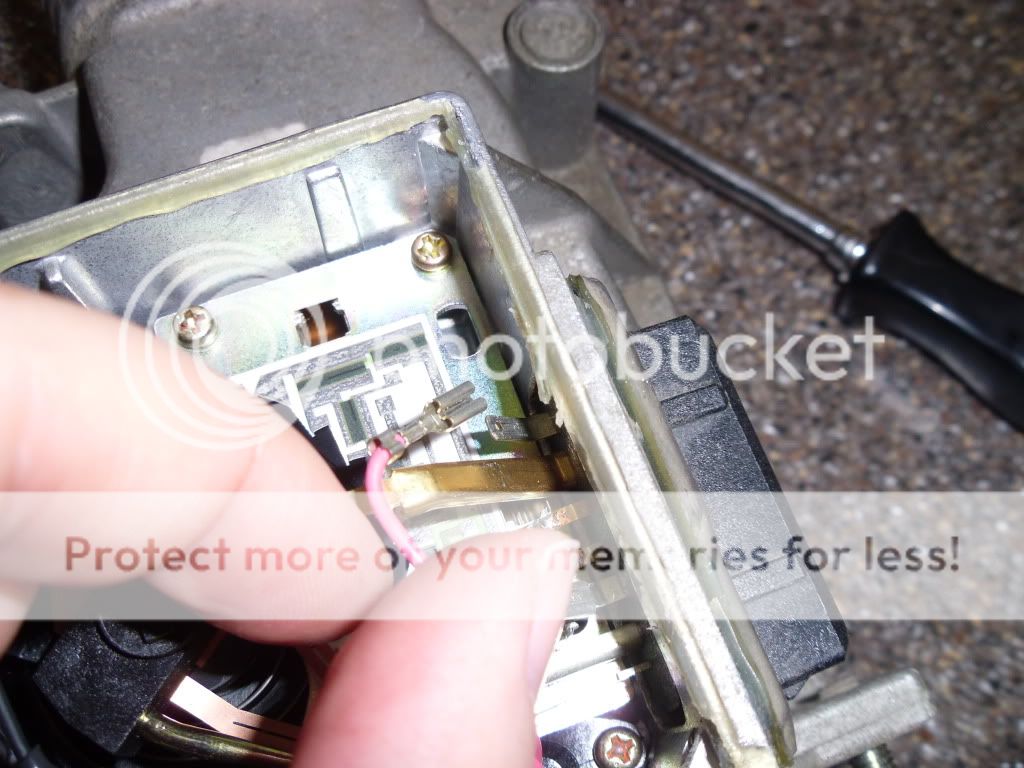

3. Remove the Pinkish/Red wires and Black wire from their corresponding terminals. A needle nose pliers may come in handy here if you cant get a good grip. REMEMBER to do these steps gently, as you do not want to cause any permanent damage to the circuitry or the plug body.

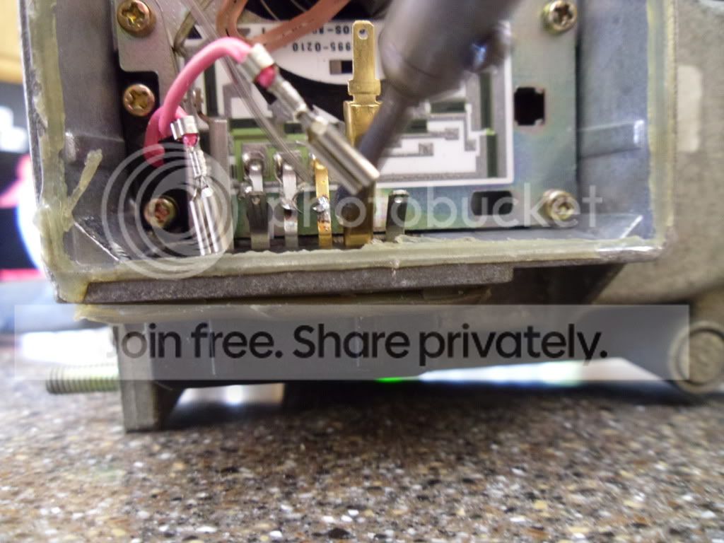

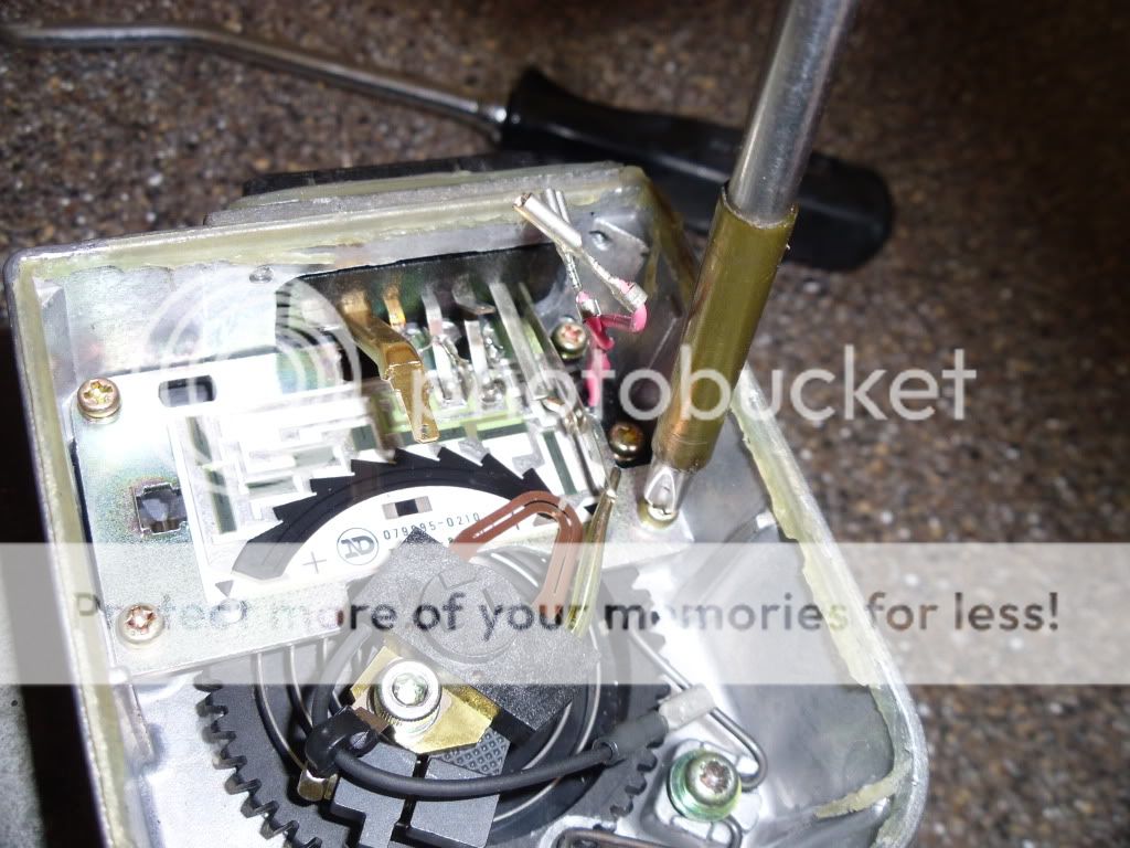

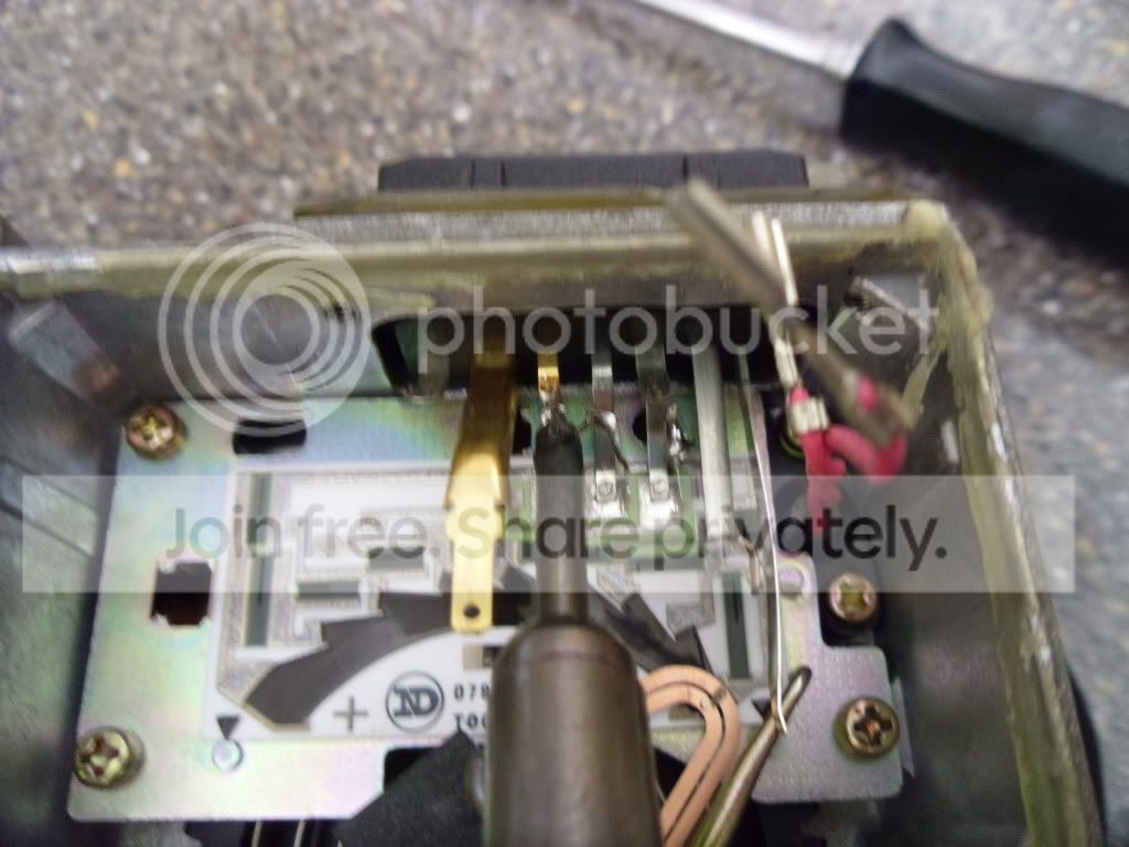

5.This is where the fun really starts. Using your hot soldering iron, (I suppose you could heat up a nail or screw with a blow torch if you didnt have the iron, carefully of course) heat up the soldered connections between the circuit board and the three prongs that feed the plug body and separate them carefully!!! In both of mine one was a brass color and the other two were silver.

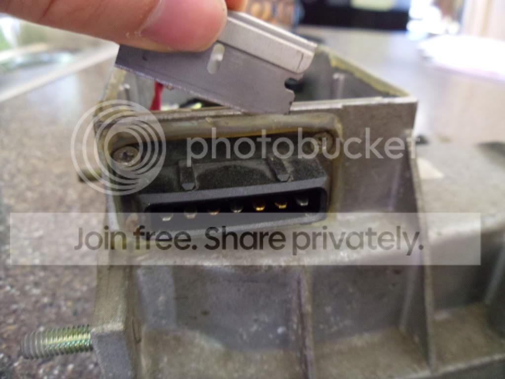

6. Next, using the razor blade, cut the silicone caulking around the plug body.

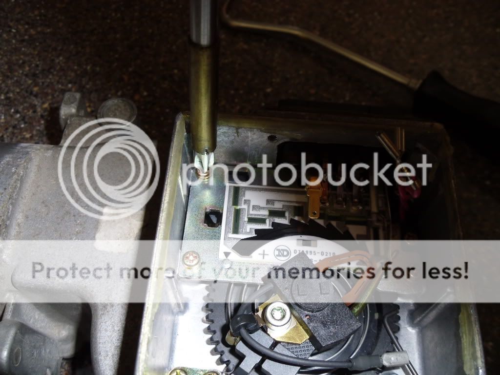

7. Remove the 4 screws holding the plug in place. CAUTION!!! Be sure to use the proper fitting screwdriver for this part of the procedure! I did not and ended up stripping out the screw and had to drill it out...not fun.

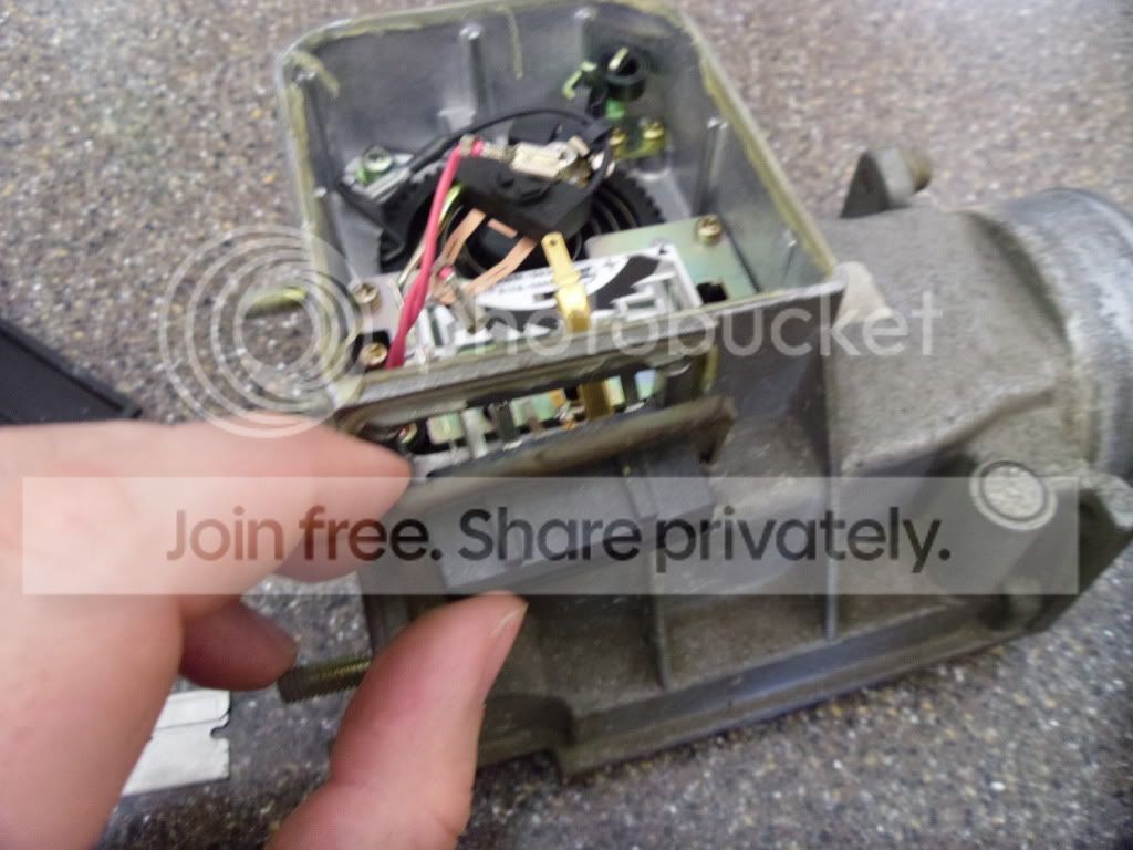

8. Remove the plug body (prying may be required).
