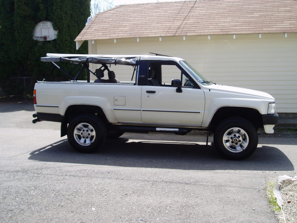

http://content.glidesociety.com/imag...7-13b2910e6a6f soft topper the way to go !!!!!

Swerks, I love your rig. Your review of that softopper was the clincher for me getting one. Well, I guess wanting one longingly and the wife picked up on it and bought for me, but diff story for a diff day. I live in Washington guys, And kept everything dry. There were a couple gaps, most notably the rear corners, but it sits out far enough the rain stayed where it was supposed to. not bad for the price.
snap the sides in when the clouds turn.... waterproof!
