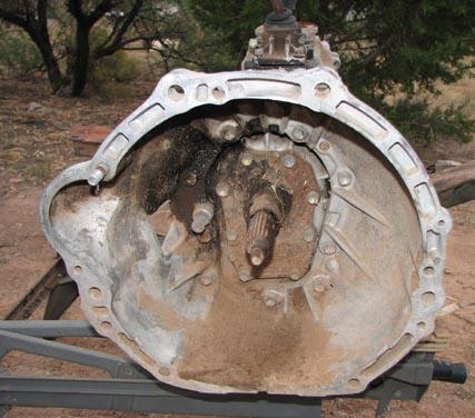

i need help too identifying a tranny. i have the a340h and correct me if im wrong put the only tranny the will easily line up with mine is the r150f. now in search of a manual 4x4 i came across this and was told it would fit but would like a second opinion. thx for any help

What truck and motor are you working with here?

i have a 90 4x4 with the 3.slow and the auto. he claims that tranny in the pic came out of a 4runner 3.0 4x4, but it looks to me like it might be from the w series which were for the 22re, i think. thants why i need the second opinion.

That sure looks like a 4cyl transmission to me.. You can see the stud used for the starter still in the bellhousing..
