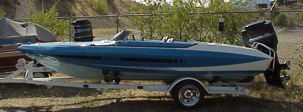

what kind of heads are those? look like something off an outboard motor.

Flamedx4's Avatar
Joined: May 2004
Posts: 3,291
From: 100 miles offshore as much as possible, & Springfield Oregon USA
Yep, good call! That *was* a 2 liter Merc 175hp. It's *now* a 2.4 liter Merc 240 hp. As a side benefit it went from a 65 mph boat to an 80 mph boat... But then again, WOT fuel consumption increased by a lot. I believe it has shower nozzles for jets...
Attached Thumbnails spark plug electrodes broken off in engine.-boat1.jpg.jpg

"Hey man, nice boat... I swear to god it is...I'll say it right to your face."
[In my best 'Donny Baker' voice]
i've always wanted to see somebody put an OMC 3.7l 4 banger into a truck. it's literally half a ford 460, but it's got a chevy bolt pattern
myself, i've just got a little 13' smoker craft with a 15hp evinrude, but it scoots me to the fishing holes good enough. might save up for a jet sled for running the rivers, though.
