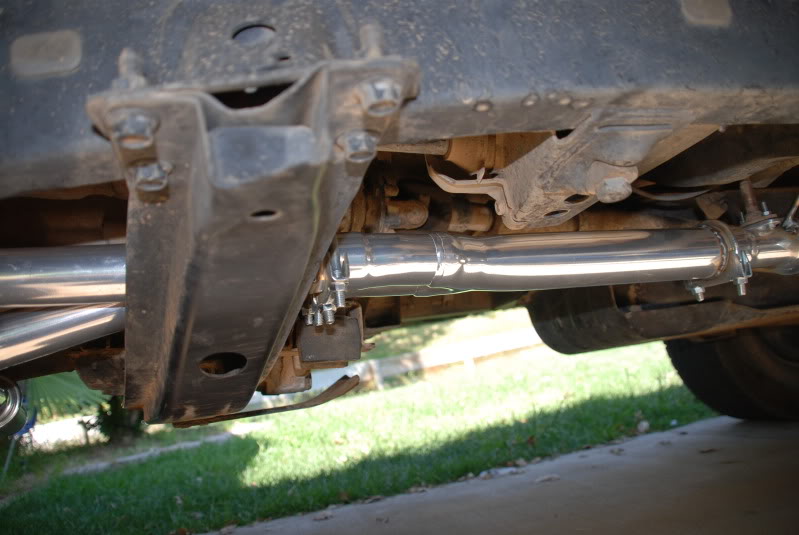

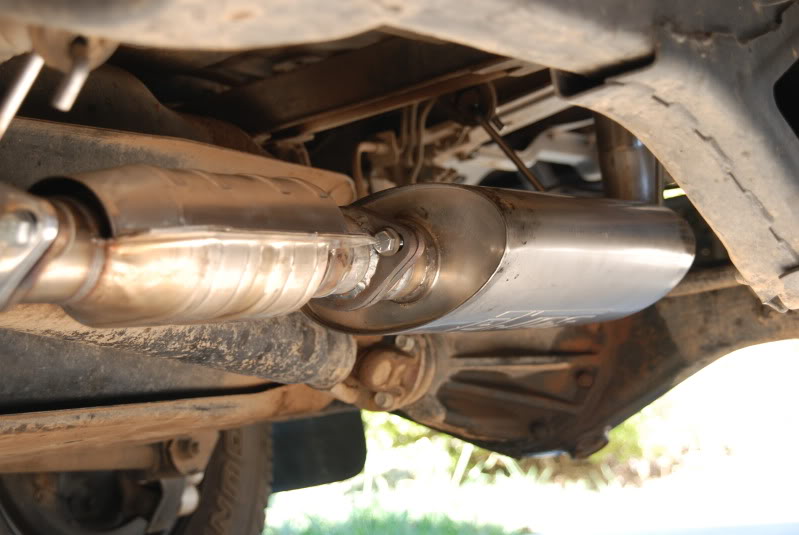

of course, I have pics of it Though, I didn't take pictures of where my o2 was located before and after, because I didn't think it would matter... heh these are of course afters, but in reality the o2 is supposed to sit back 6-8 inches. when I put the headers on, I could not finish putting the cross over on because the stock cat was in the way. so i had to modify it and push the o2 and cat further to the back of the truck. my muffler is maybe 2 inches from the axle... which is where the tail pipe bends vertically.

Moving your cat or o2 sensor shouldn't yeild any problems... it didn't for me, other than the fact that I put a high flow cat on and my CEL came on for a few days, but it mysteriously went off, and hasn't come on since. installing my exhaust system did make my idle out of whack for a few, but I just reset the ECU and it went back to normal.
EDIT: I found a before. this was my hacked up cat back but if you can compare the before and after, you can see my exhaust is pushed back quite a bit from stock.

Nice exhaust set up! Thanks for the pics! If I'm looking at this right, you moved the O2 sensor further toward the rear, right? In my case, I would be taking out 8" from the pipe in front of the frame crossmember, causing the O2 and everything else to move forward, and the O2 wire doesn't reach that far forward. Also, is it just me, or does your O2 wire enter the body near the middle? Mine enters right under the doorframe. But then again, mines a 22RE, and I see yours is a 3.0, so I'd expect some differences.

Yep. I moved mine back further. its lined up right next to the gas tank, as you can see in the picture. I would expect the o2 sensor to be easier to figure out if your moving it toward the front? search under your truck more... there should be clips and what not holding up the o2 sensor wire.
