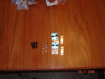

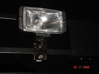

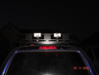

here's what I came up with:
2 double wide corner braces 2"
2 mending plate/ zinc plate 2"
4 m6-1.00X30 socket head cap screws
4 6mm washers
4 nylon lock nuts
Black gloss Krylon (already had it)
2 Driving lights (already had them)
what do ya think?
Attached Thumbnails Roof rack light mounting-roof-rack-lights-1.jpg   Roof rack light mounting-roof-rack-lights-2.jpg   Roof rack light mounting-roof-rack-light-mounting.jpg

everything is snug and no movement from driving... Think I'm gonna make 4 more sets!
