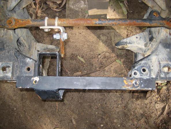

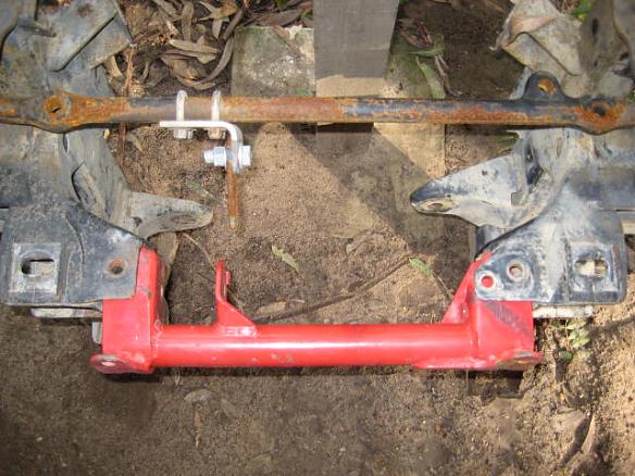

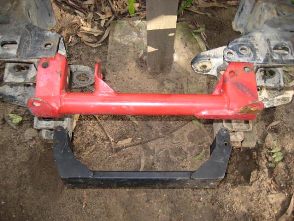

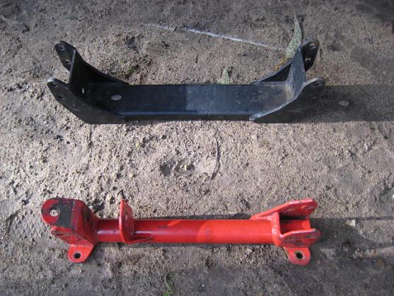

I think were getting off track on this thread, sorry about that. Anyway back to the Rancho kit. I wanted to point out a few other details about the Differential Drop brackets that came with the Rancho kit. In the following photos I am showing only the crossmember brackets and not the two brackets for second and third attachment points. As you can see in the photos the brackets lower the differential but not the pivot points for the LCA. This will result in about 3" of lost running ground clearance.

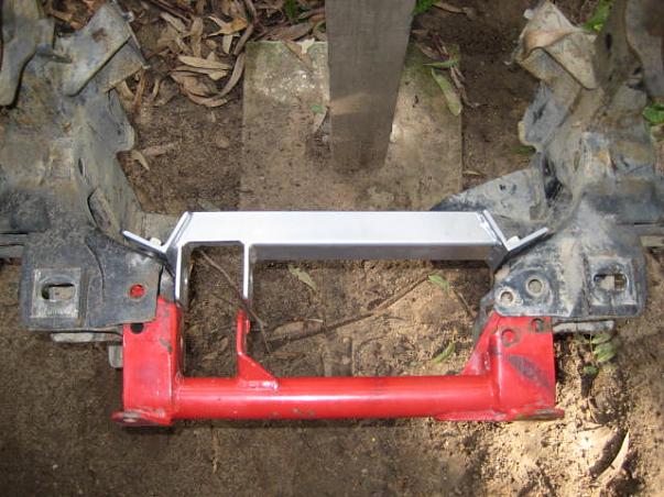

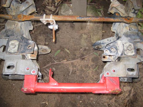

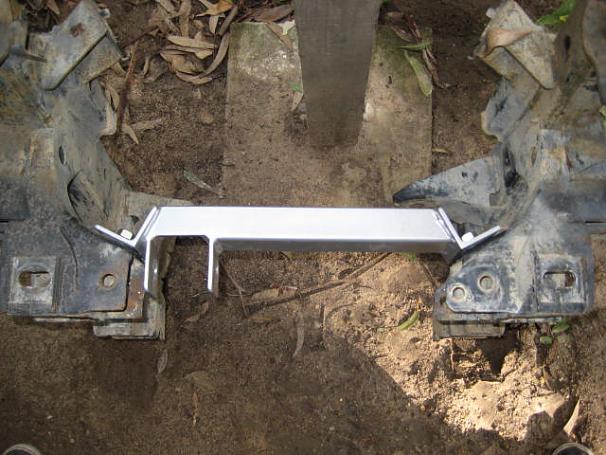

In the next photo I am showing a few Diff Drop Crossmember brackets a expirimented with. The top bracket lowered the diff and only lost 1" of running ground clearance plus it added some protection to the differential itself. 3rd down was a stock crossmember I built that only lowerd the diff 1-1/2" but also lost the same amount in running ground clearance. The bottom bracket lowered 1-1/2" and didn't loose much ground clearance because it supported from above. This was great for installation and removal for the front diff but offered no protection. For this method you would want to add some sort of trail armor.

Just for gigles I snapped a photo of the Rancho bracket stacked onto a Pro Comp 4" drop bracket kit.

The difference with a straight axle is as the suspension cycles the diff moves with it. In IFS the diff is static. So with IFS as the suspension compresses the diff gets closer to the ground. Fully compressed with the Rancho dif drop installed the running ground clearance is only a couple of inches off the ground. Running in the whoops at speed with a high crown and you are grading the road. With that said the attachment points in this set up isn't very strong so your very likely to do damage.
The best solution is to install some custom CV axles and not lower the diff at all. Tried4x2, it sounds like you might have all you will need to go this route. UCAs, centerlink, and Tie Rod Adjusers is what Downey sold along with mega travel ball joints and slip yoke axle shafts.

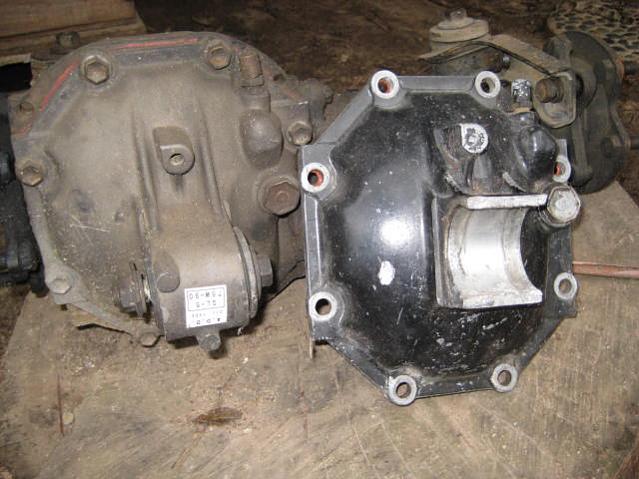

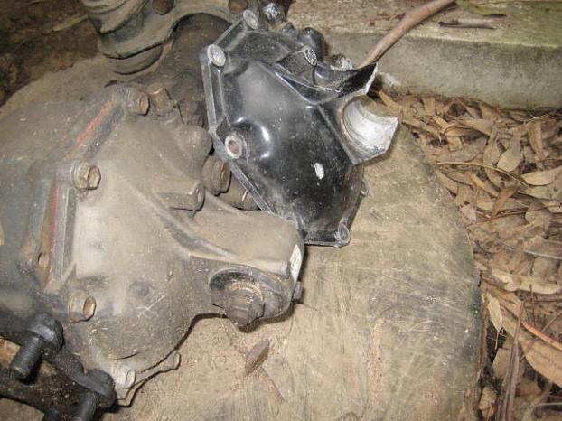

Here is some of the damage to the front diff that can result from impact.

hey blaze........that's NOT a toyota diff cover on the right (the damaged one...)
the angle for the front mount is different than the good one.........
or atleast it doesn't look like one to me?

Camo you have a good eye! But it is a Toyota diff cover. There are some changes over the years with different models and different options. If memory serves me correct the damaged one is from the Fordota (a 1986 4x4 pickUp) and the good one was from a 1998 T-100. Cant get anything by you guys! I might also point out the angle might just be a result of the damaged diff cover leaning back. The camera angle may also be a factor. They should be interchangable!
