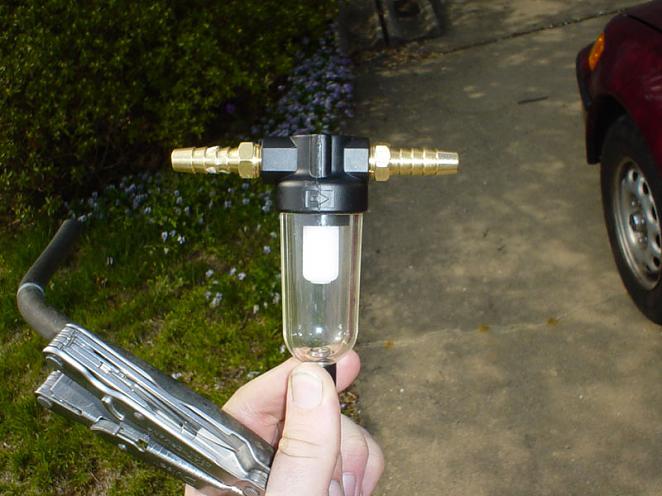

Does anyone use an oil Seperator or PCV catch can on their rig? Its supposed to catch all the oil that blows through the PCV valve and trap it before it enters the intake manifold and get burned up in your engine. Just wondering what people have heard about these, my buddy runs one on his H22 Accord.

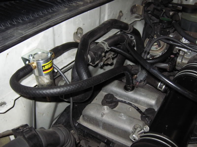

Just did mine, not sure why there is condensation in it....
Couldnt fine anywhere but here to mount it so ive got a hood snake until i can get a 90* elbow
