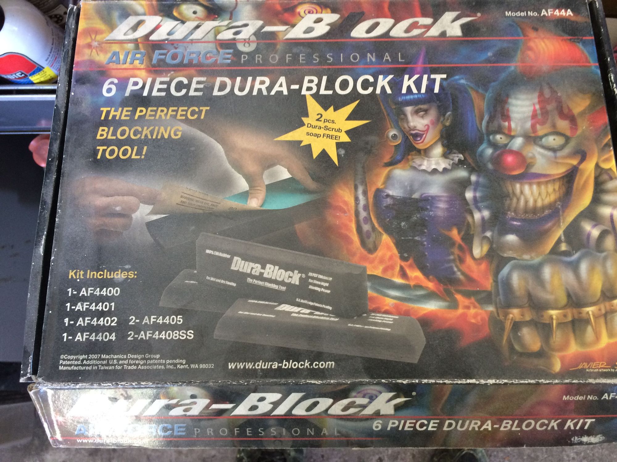

I almost forgot a couple things. First, if you don't like the feeling of your hands on fire, wear rubber gloves when sanding with fine grit sandpaper (600 grit and up). Without gloves you will lose your fingerprints which can be a good or a bad thing. Second is, use a good quality sanding block. Durablock makes a great product and you can get a full set on Amazon for around $40. I prefer a rigid block sanding for filler and primer but for paint these work great
