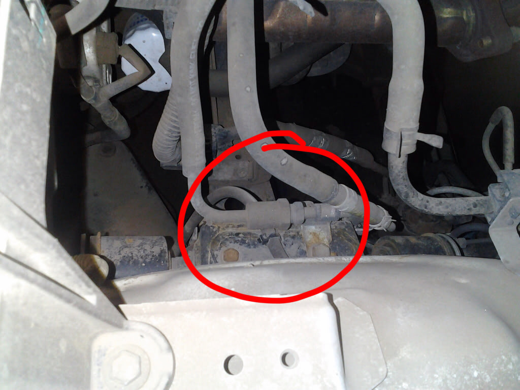

Terry, what I was trying to point out is that it's in different places for each truck. My '90 4x4 3VZ had a frame mounted, but I think most 22RE trucks have it mounted under the intake manifold, avd like you said, it even varys with older trucks.
OP, what year truck do you want to do this on? I'm sure it's possible, just probably a little time consuming. Since you are saying that you have a truck with the filter on the frame, you could probably bypass the filter on the frame, then mount a filter somewhere under the hood. I know on my T100, there is a junction where the hard line from the frame connects to the soft line that goes into the motor.

This is the junction I'm talking about. Maybe you could find a similar junction on the truck you want to do this on and find the thread size to install a filter here.

My truck is a 1989 2wd 22r single cab base model. First year of the newest body style and the last year the 22r was offered.
I don't see it as being difficult at all to move. I would simply put a securely fastened coupler between the lines where the filter is now and then move the filter to under the hood shortly before the carburetor.

Ok. I was thinking you were working with what I posted. I'd just grab yourself some appropriately sized fuel line from napa and have at it. With a system like that you should be able to put it just about wherever you want lol.
