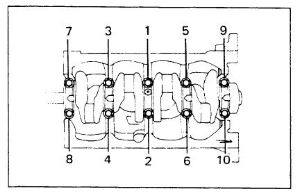

yep, it was actually VERY easy. dropping the diff and oil pan were way harder than actually replacing the bearings. it actually only took me a couple hours, to replace all the mains (already had the caps off), and put the oil pan back on.
I actually pulled all 5 main bearing caps, and laid them in order, in a box, labeling which end was the front of the motor. then replaced the top halves of all 5 bearings, and then bolted the caps up. and like rock dawg said....get them all hand tight before putting final torque on them.
I attached the FSM diagram about the order in which to torque down the mains.
Attached Thumbnails main bearings...to replace? or not-main-bearing-torque-order.jpg
