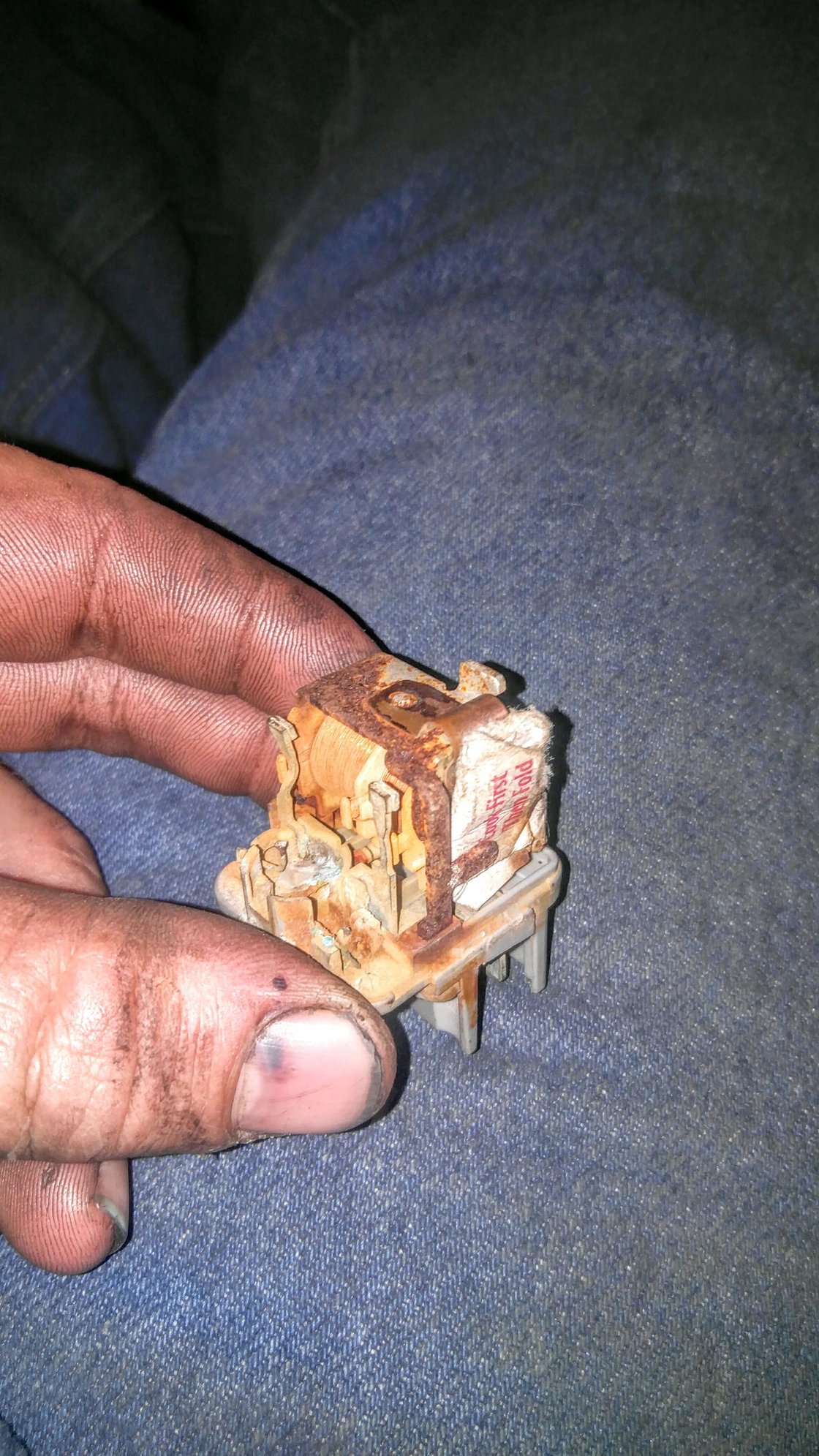

Had a 92 pickup come in today with an intermittent starting problem. Would crank but not run. Guy took it to another local shop first. They told him the CO relay was bad. Told him they replaced it and charged him like $100 for it. Winds up doing it again. Charges him $75 for a service call and then $410 for a fuel pump. Didn't fix the problem. Refunded him $250 for labor but that was it. They then told him it was because the connector for the CO relay was burned up and then gave up on it.
When I got it I drove the truck into the shop. Found the CO relay was not new and the connector was completely gone. Just bare terminals. Noticed only two of the five wires were connected to the relay. The other three were just taped together with duct tape. The two wires connected were battery feed and fuel pump feed. The truck shouldn't run with only those two wires connected. So i pulled the relay to test it. It was a factory Toyota relay and was likely original to the truck. There wasn't a pin diagram on the relay and no numbering for the pins so I was having a hard time figuring out what I needed to test for. I figured there was no easier way to check what pin is what than to pop the cover off.
Upon popping the cover this is what I found.
Their "fix" was jamming a piece of Hot Pocket microwave sleeve into it to hold the contact closed. That explains why it came back. It in fact was bad and badly rusted. We replaced it with a new one and it was good to go. Couldn't find a replacement connector anywhere. Ended up putting some heat shrink on the individual terminals and reconnected them. I then taped them up tightly. Not too happy with it but didn't have many options.
