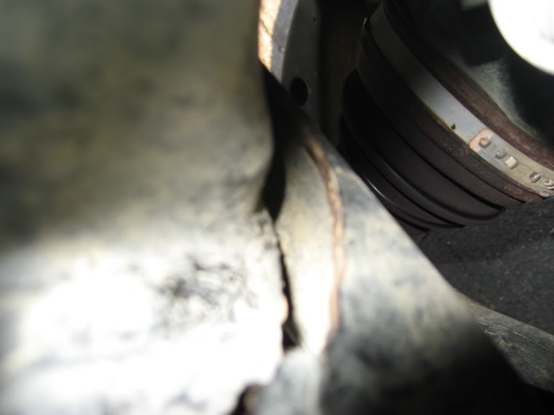

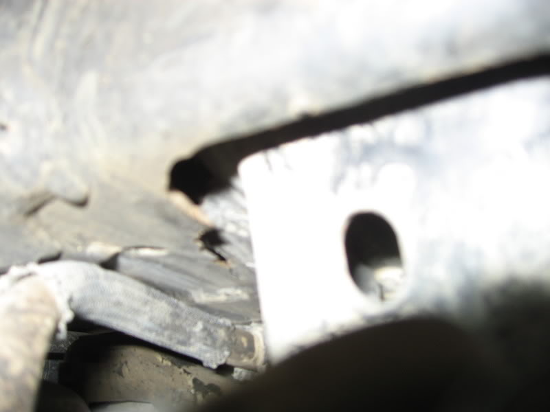

Originally Posted by Matt16
I am curious whether anyone has actually had a frame problem.
Actually there are several cases of the fully boxed frame portion of some '05-06 Tacomas cracking by the motor mounts: ttora Cracked Frame 2005 thread
This has been indicated by the fan hitting the shroud...this particular example is from a truck that has been used extensively, however there are other cases of it...
