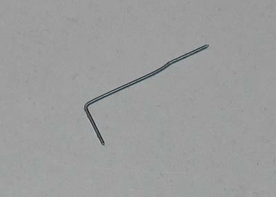

Or it should be titled "How a paperclip saved me a few bucks"
I've been driving with two wiper washer nozzles (one on on each side) that did not work. So I finally got off my duff and fixed it. The first thing i did was to take a staple to the nozzle to push any debris loose into the nozzle. On both of the clogged nozzle, there was resistance. I then turned the washers on and they both worked. I am pretty confident that it was just accumulated loose dirt and that it was shot out of the nozzle. if not, i'll unhook the hoses from the plastic T's and clean out the debris from there.

Bob, how long did it take you to setup that paperclip shot? Boy, you should become a pro photog with that. Have you got a portfolio ready?
Nice write-up though really!
