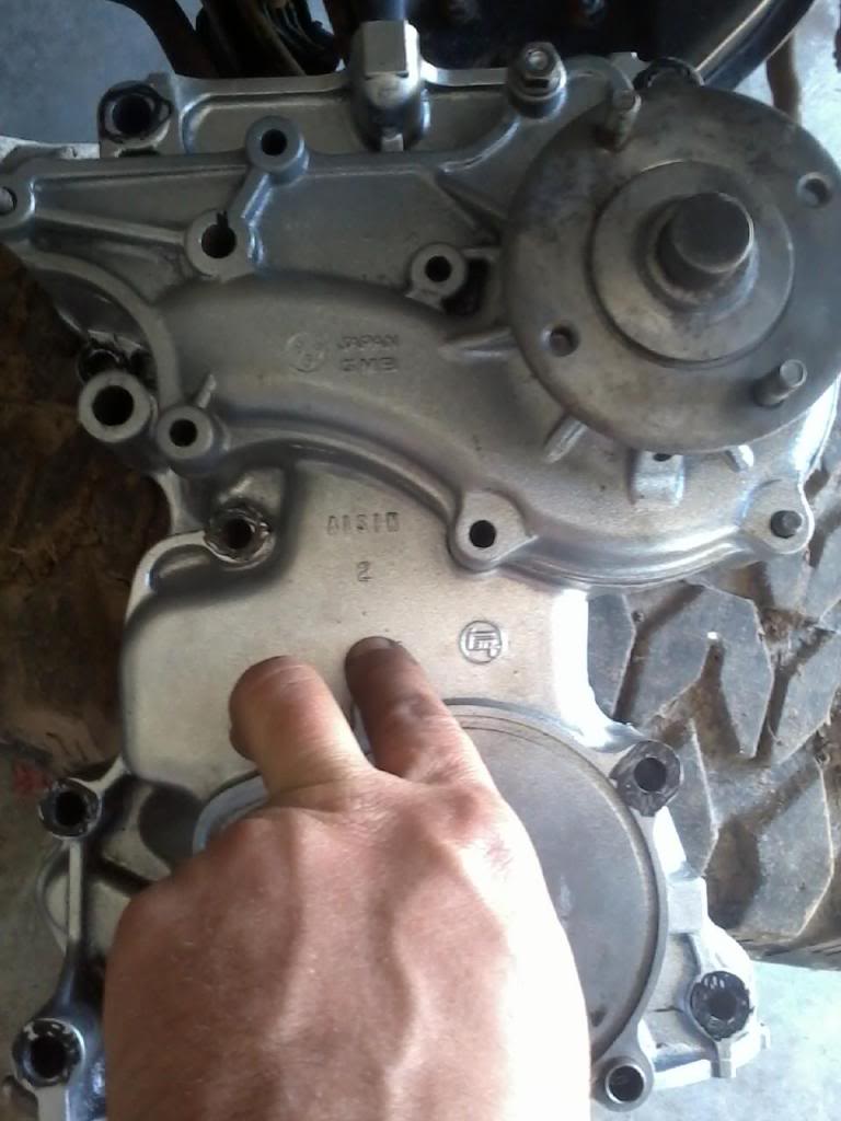

84 and older. 22r has no dimples/circles and the number "2" on it. Twistedyota got it right on the height thing, see the last picture for a good example. I also tried to mark which bolt holes for removing the timing cover on down the road when I have to do a chain again. Hope it wont burn off but it if does I tried to come up with an easier way. Never can remember which bolts they are.

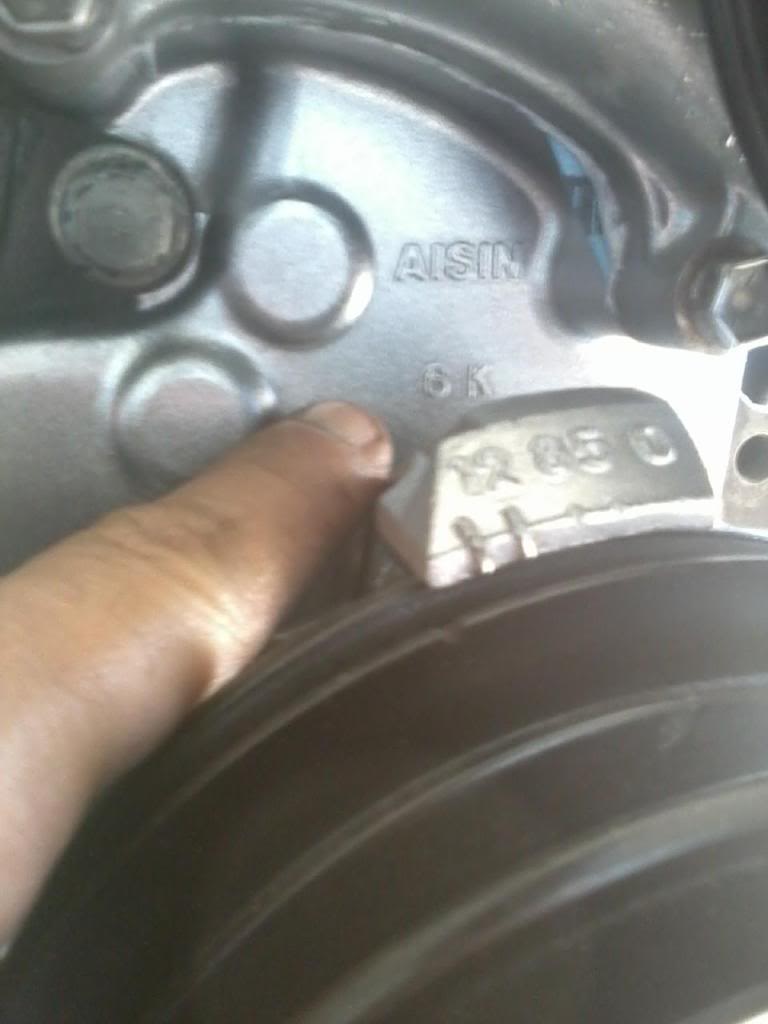

22re has "6k" and dimples/circles. 85 and up.

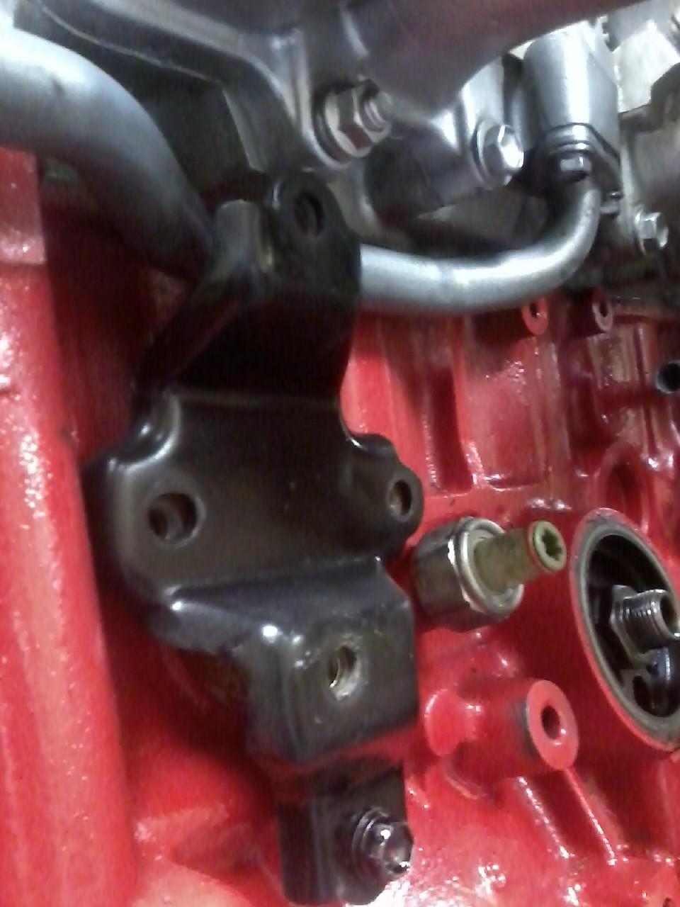

On a 84 and older block, the old style block dont have a place for the Knock Sensor or Fuel Filter mount and both are on the passenger side. I understand the timing kits are not interchangeable.
I am sure there are some other difference but these are the quickest way to identify which block you have and some differences in my opinio.
The 85 and newer blocks will have a place for the fuel filter mount and knock sensor shown below.
