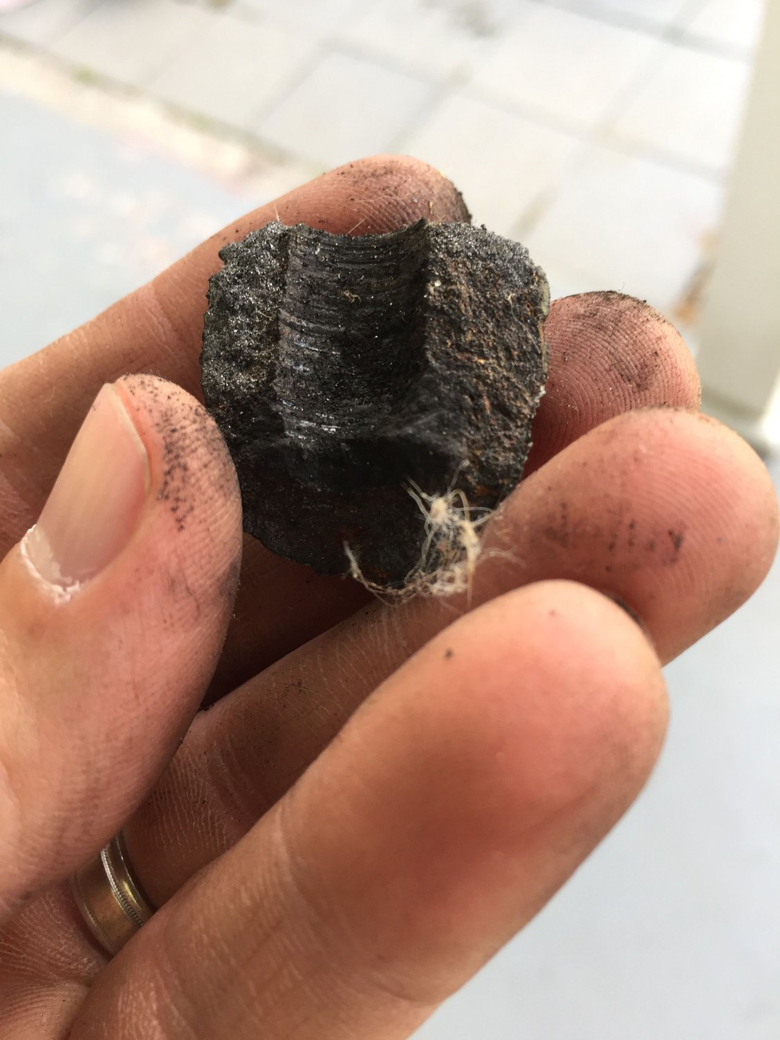

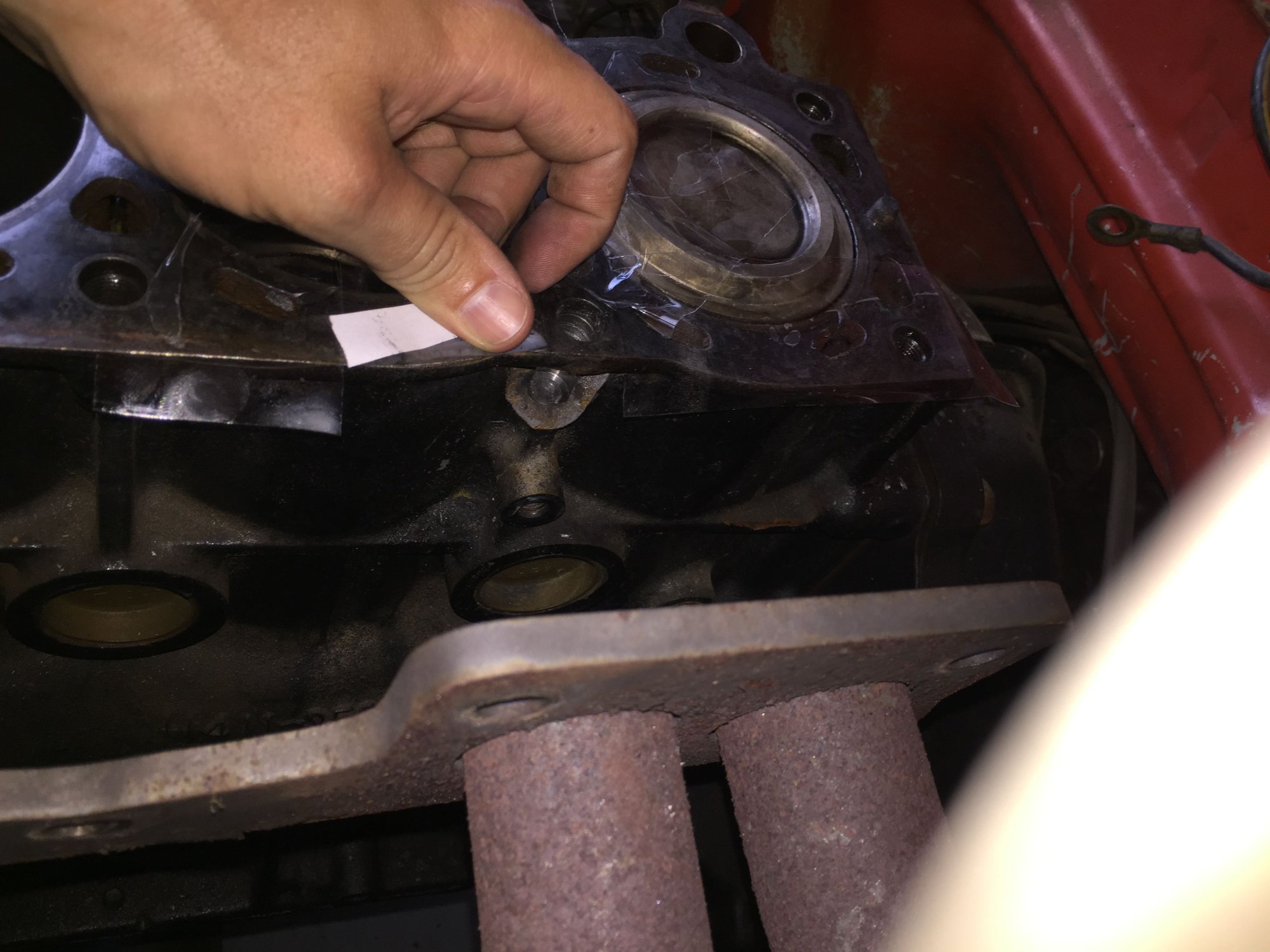

Greetings all. Had a head gasket go on my 22R. Got head machined ready to go back on, etc. #3 bolt hole in block stripped. Went to drill out for thread insert, and the block around the outside of the bolt hole literally fell apart. Apart from bang my head against the wall and getting a new block, I'm open to advice. The truck is a 1980, the engine was rebuilt and has less than 4K on it too!

Pictures please.

The piece that came shooting off the block.
Piece came from just beneath my thumb.

Wow! That's not gonna buff out.
Expensive specialist repair might fix it, but another block would be best.
