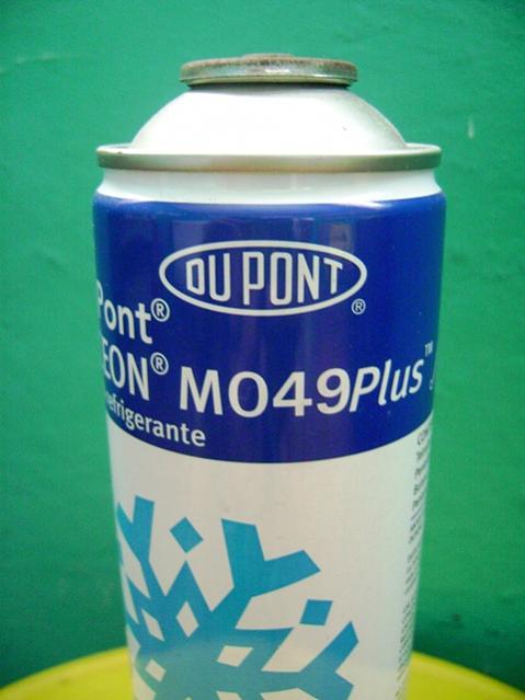

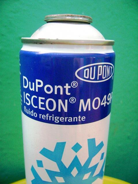

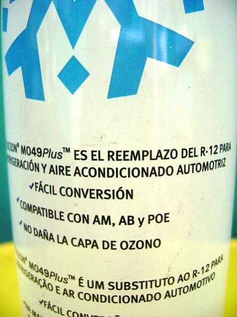

In Acapulco I bought this Dupont ISCEON M049Plus. 26oz. as R12 for my 86.
Hope this helps, good luck..!

Old Aug 3, 2010 | 03:05 PM
morena67's Avatar
Posts: 253
From: Acapulco, Gro. Mexico.
...It cost me around 15 US dollars.
