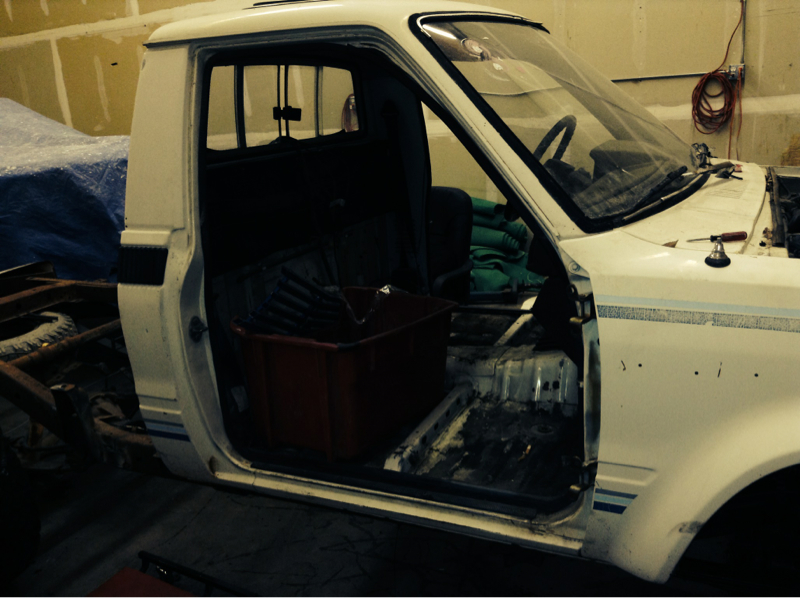

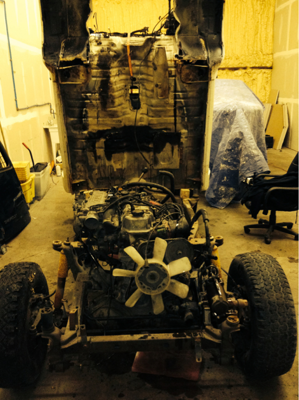

Sorry about that guys totally spaced it! Well I have a 84 toyota pickup 4wd, it's used and been sitting for 11 year in a field. It's in pieces right now, the bottom of the cab is rusted out and has holes in it so I have to weld metal in it, but anyway it is drive able, we drove it back from the plains to Colorado Springs, it just needs a few things. ( can't really remember the town that the guy lived in ). I want to be able to tow stuff, and have power, (like other cars,trailers,work tools etc) but that's just a dream, that I don't know how far it will get. But I also want to use it as my toy too, especially when the family goes camping. Here's a few picks that I have, my uncle (that we do not speak of) came in and started to take things apart and sold my seats and carpets, so these are right after he did that
