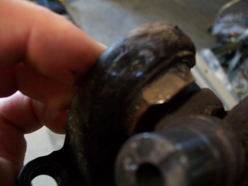

Thanks for the advice guys. I talked to my local drive shaft shop today and they said pretty much the same thing you guys did about the yoke.
Also when I removed it I saw what I think is causing my vibration. The front u joint is destroyed. The caps broke apart.

I'm sure you guys will like this.........
This is the front joint. I also had to replace the yoke. Drive line shop did it all.
Forgot to mention. The truck drives amazingly now. No crazy vibration at 45mph and above. I never new the truck when it didn't ride like crap. I'm starting to really like this little truck.
If it was that nasty/rusty/seized, I would have torched the old joint out and cleaned the yoke up...
