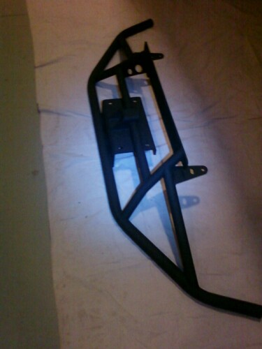

heres the bumper
wrong picture. front bumper!!!!

soo...i take it we're talking about the front bumper right LOL
still..best thing would be to drill holes in the tube, or weld tabs!
Is that flat black paint?
If it is, just sand some of it off and weld tabs on the back... seriously..
Flat black paint is easy to fix with a can of primer and a can of flat black or satin black..

no. in the picture it looks like that cuz of the lighting.
all together it has 4 coats primer. 3 coats gloss black. and 2 coats clear. and its welded onto the truck now cuz a buddy had a miller welder at the time.
what if i put a piece of steel like 2 inches wide. .375 under the winch so it was bolted through. and drilled holes in that for all the lights?
does that make sense?

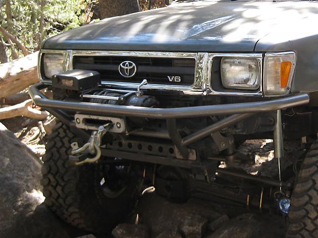

do u got a pic of the bumper on your truck? looks like the lights wont fit beside the winch. where u goin to mount them? on top?
Old Feb 14, 2010 | 05:39 PM
4runner dude's Avatar
Joined: Dec 2009
Posts: 57
From: pasco washington
no i dont have a front view of it right now.
here is one from marlin crawler site.
i would mount the lightson the inside of the headlights. and then a couple more inches in from that. if i do 4
or just the 2. i would put them a couple inches in from the headlights
