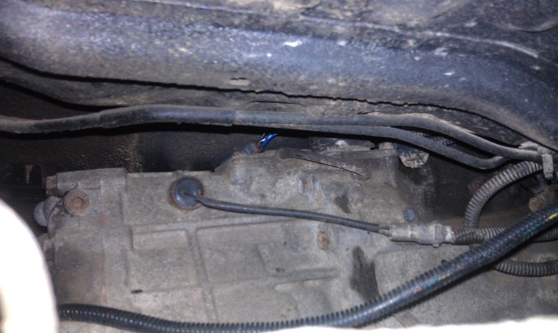

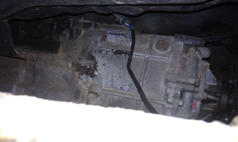

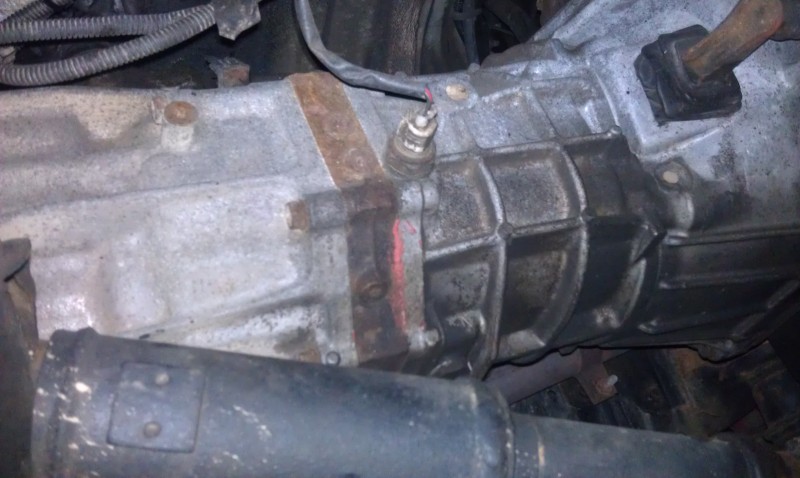

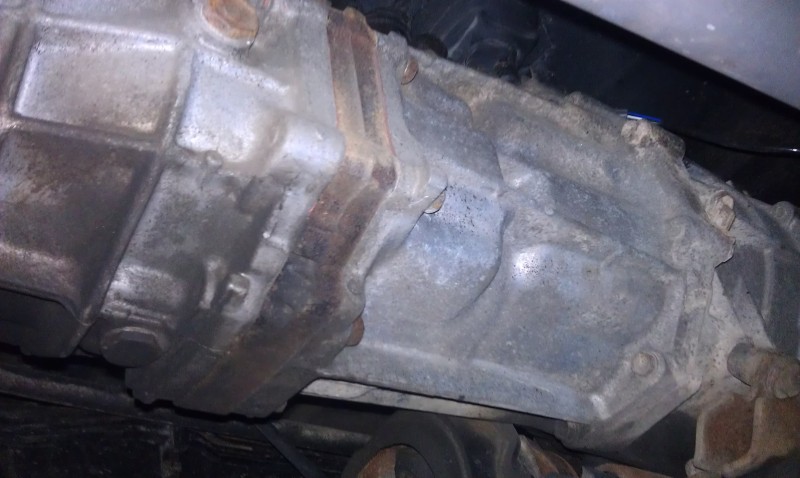

well I finally had some free day light to check under the truck and to my surprise my transmission looks like NEITHER of the transmissions that irab88 posted
it had the sensor on the side like the R150, I'm pretty sure it's a front shift setup but almost no defining features of those transmissions match whats in my truck. :-/

@dropzone: I've already determined that I have a chain style transfer case, I'm trying to identify the transmission that's in front of it.
I snapped some pics:
