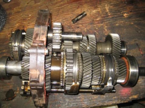

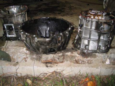

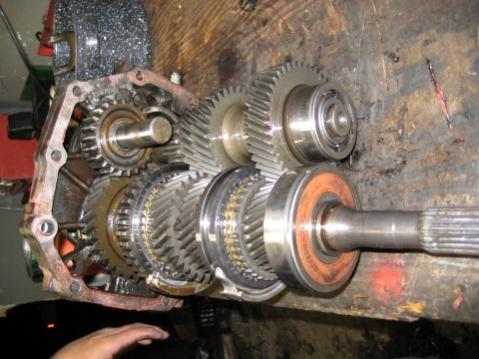

Ed pulled the transmission cases off to take a look inside. See the photos. It looks like the synchros are all bad and 5th gear has some goughed teeth. This tranny looks exactly like the one in the FSM: http://www.the-roo.com/4runner/Trans...omponen(2).pdf Notice that there is one shift lever in the transmission. The other shift lever is in the transfer case. (not shown) The picture shown on the previously mentioned website looks like a representative tranny, but not the R150F (but what do I know, I'm a newbie). We'll call up Marlin tomorrow to see if they can help us with some parts.
Click on the thumbnails to make them bigger. The casting number I found is on the bottom of the orange intermediate plate. Fifth gear is to the left on the first picture. Synchros are the brass rings between the gears. It's hard to see in the pictures, but the synchro splines are worn from triangles to little nubs.
