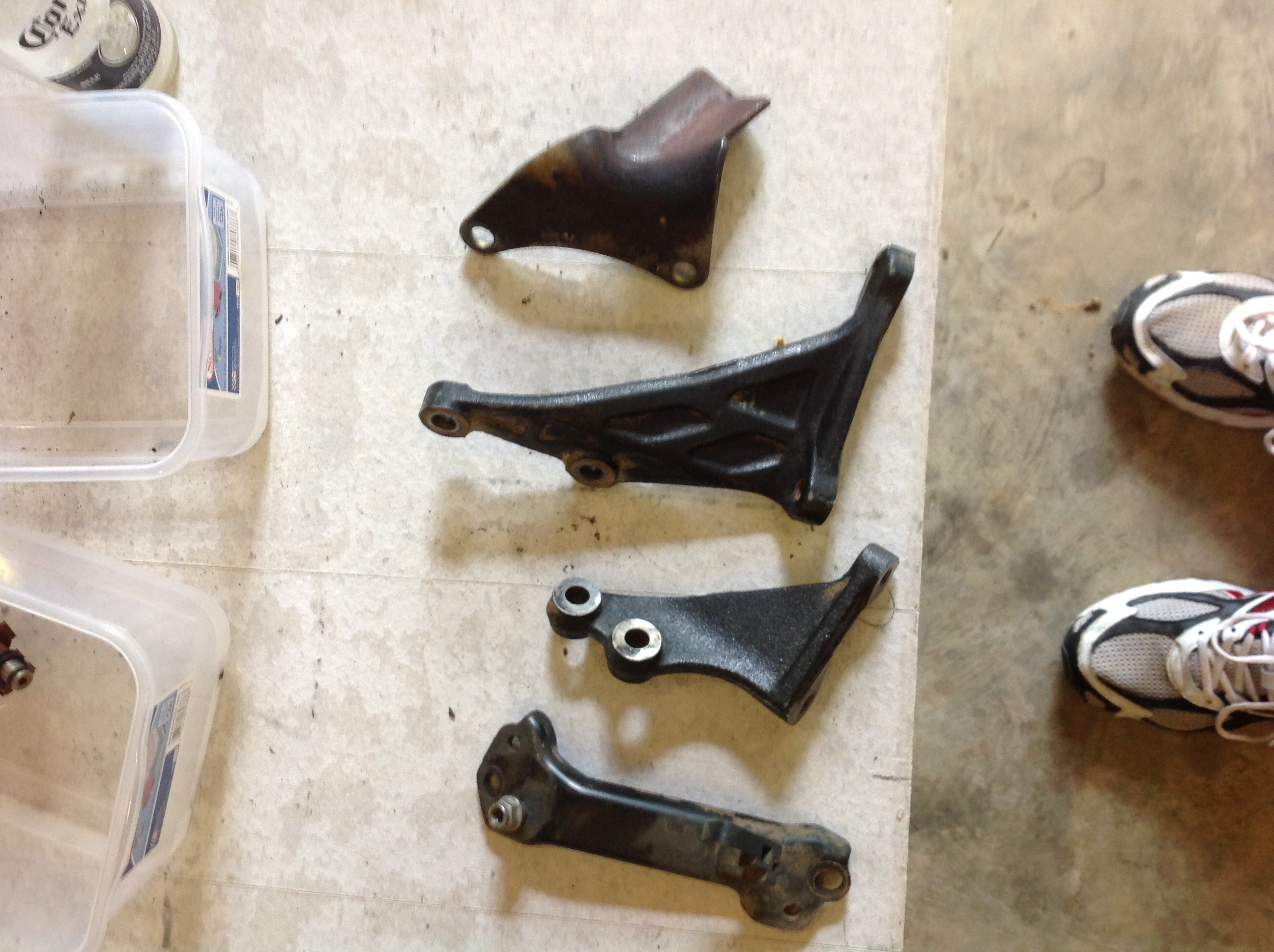

Looking for advice as to where these brackets belong.

Top one is to mount the exhaust pipe (downpipe) to the trans bellhousing for support, Good idea to use as it takes stress off the #6 cylinder, My opinion of course.
2 and 3 are lower engine to trans support, Really suggest using them, Don't forget the cover plate.
4th one I have seen and have no clue.
