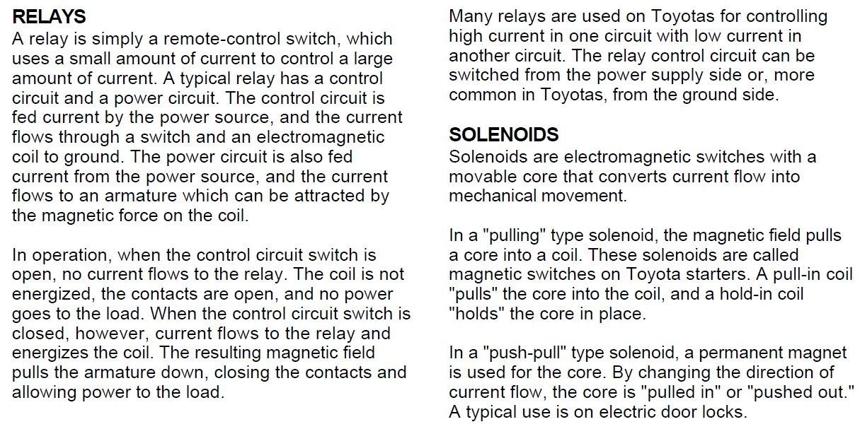

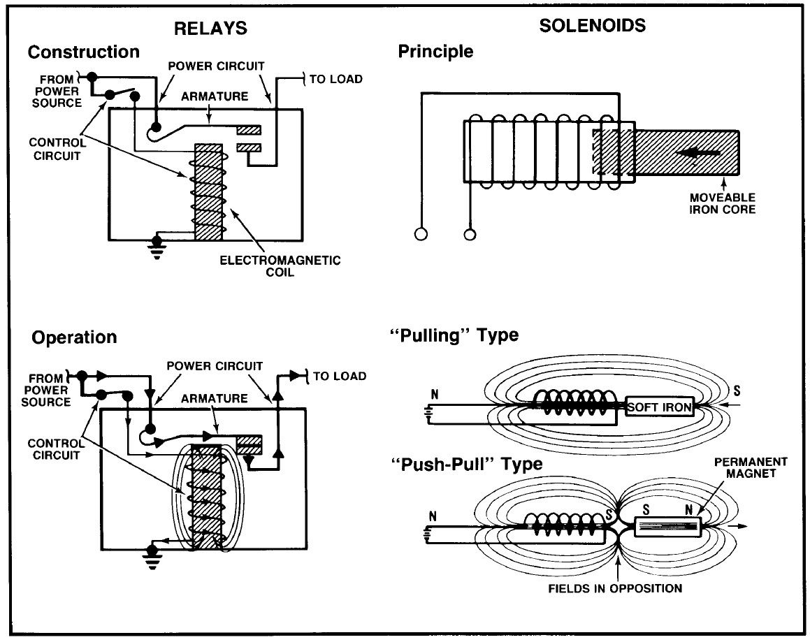

No, it doesn't actually. Like I said, it's just a switch, but a remote-controlled one like any other relay. And there are no resistors in it either. I just had mine apart a few weeks ago. So I know EXACTLY what is in there. It's like what's described below.
BTW, what's a COP?
Originally Posted by toyotacharles
I wonder if the relay failing and now that its bypassed might have some bearing on it?
I can't see how. The relay is only a remote-control power switch. Just like a light switch on the wall in your home(aside from not being manually controlled)it's only "ON/OFF". And just like switching the light switch doesn't hurt anything, neither would a malfunctioning relay. Relatively speaking that is. As some electrical/electronic components/mechanisms/devices are duty rated in "on/off cycle" expectancy over the unit's lifetime. Generally the number of cycles is in the many tens to hundreds of thousands, or even millions, for those types of things though.(Relatively as in...it doesn't really apply here, because how many times are you going to start/stop the truck's engine in it's lifetime?, a Circuit Opening Relay or any other electrical/electronic component in question "should" easily last longer than that many on/off cyles since they're not scheduled maintenance parts that ever "need" replaced if they ain't broke, meaning they probably aren't duty rated in "on/off cycles" anyways, but I thought I'd mention it because the concept of "lifetime on/off cyle expectancy" is related)

Excuse me!? My haste. You mean your haste. Maybe you didn't notice I said "resistor", NOT "capacitor". 2 different things I'm afraid...BTW, do you even know why it's there? Well...I'd tell you, but you'll figure it out eventually right? Better figure this out first though:
Capacitor: A capacitor (formerly known as condenser) is a device for storing electric charge. The forms of practical capacitors vary widely, but all contain at least two conductors separated by a non-conductor. Capacitors used as parts of electrical systems, for example, consist of metal foils separated by a layer of insulating film.
Resistor: A resistor is a two-terminal passive electronic component that implements electrical resistance as a circuit element. When a voltage E is applied across the terminals of a resistor, a current I will flow through the resistor in direct proportion to that voltage. This constant of proportionality is called conductance, G. The reciprocal of the conductance is known as the resistance R, since, with a given voltage E, a larger value of R further "resists" the flow of current I as given by Ohm's law:
