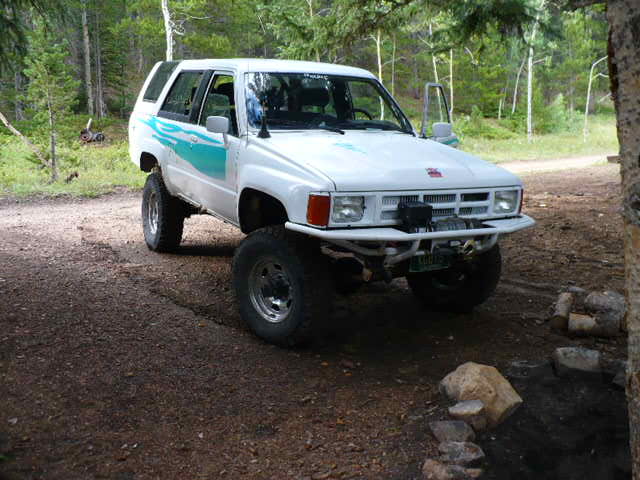

i'm looking at putting a 31x10.5r15 on a 15x6 taco steelie, and was wondering if there were any adverse effects. this will be my dd at 100 miles a day. and this is also a pic request, if anyone has this set-up

found one pic:
(31x10.5r15 on 15x6)
