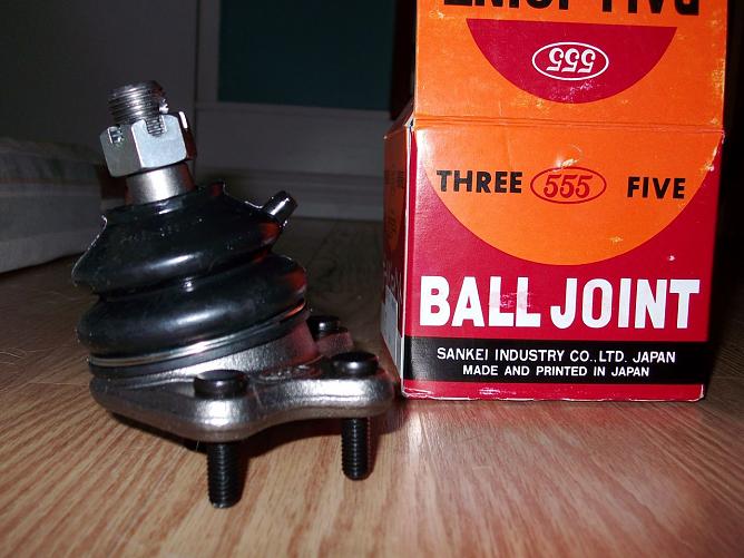

2nd... I'd ONLY use Toyota or Moog joints... Pretty sure the Moog's are Japan units... WhatEVER you do, ONLY USE MADE IN JAPAN PARTS!!!! OEM if you can... read, for quality control.

I would be very skeptable of those ball joints they are quoting you. That is way to low of a price for them to be any good. Ball joints is a place you don't want to skimp on. Usually OEM ball joints go for around $60-$70 a piece and they are quoting you less than that for a pair

$25 for for ball joints? Not sure I'd want to riding on those, seems to cheap.

1) I have a pickle fork, do I need to rent a puller and press from Kragen?When I went to Kragen, they had a ball joint press and a pitman and pitman/tie rod puller for rent, and they were all for rent separately, not in a set---nothing labeled as a ball joint puller.
2) The sankei 555 ball joints, both lower and upper, have these tiny relief nipples on the side, why? In all the threads I have looked at, these are never mentioned.Suspension Quote 4Runner-ball-joint-1.jpg
3) Aside from the new parts, I got my socket set, vice grips, cheater bar, jack stands, floor jack, parts cleaner, possibly renting the puller and press tomorrow (I'll see what you all say), grease gun and grease, my computer with various DIY Ball joint threads at the ready, address of closest auto parts store to my friend's house, camera to document each step, beer, a friend, a garage, and all day on the holy sabbath. Am I missing anything crucial?
Thanks again for any feedback, you all are so awesome for inspiring newbies, such as myself, to get under the hood and do stuff for ourselves.

Originally Posted by Smelliottkuhn
So I am going to do the work myself this Sunday. I have ordered the Idler arm bushings from Toyota, got 4 new Bilstein Heavy Duty shocks off partsgeek.com for $69/ea., and 4 new Sankei 555 ball joints. With all parts, and tools I am currently just shy of $600--if all goes well, I will be saving myself about $230 and gaining a whole bunch of knowledge, frustration, and hopefully in the end, satisfaction
Questions I have going into this, and I have been reading endless threads here on yotatech and other forums:
2) The sankei 555 ball joints, both lower and upper, have these tiny relief nipples on the side, why? In all the threads I have looked at, these are never mentioned.Attachment 83713
Final question? you have been given some damn good advice on how tho check bell joints, you just went ahead and bought them anyway. It takes longer to jack the truck up than it does to check the ball joints. Sounds like you just want to spend time and money.
You didnt listen about getting the tire rebalanced, that should be done from time to time along with rotating(5000 miles rotate)All the above advice above about troubleshooting was right on before you start parts slinging...oh well
Advice: If it aint broke dont mess with it.
BTW: squeezing a grease boot on any joint to tell if its wore out is BS.
Enjoy replacing parts you prolly didnt need to cause you dodnt listen to previous advice
Well i did listen to advice: I had Toyota in Mexico, look at my front end, and they are the ones who initially recommended having the ball joints and shocks replaced. I had previous work done there, and a friend that worked there, and I found them to be honest a reputable--however I didn't have the funds at the time. Also, I shook the car at 12:00 and I did have movement, which according to tried4x2signN, was a sign of ball joint and bushing wear. I probably could have gotten the car balanced to further check things out, but to be honest, I think the 20 year old original stock front end, and a year on the roads in Mexico, whether in need now or not, is in need of being replaced sooner than later. Currently I have the cash, the time, and the desire to step up to the challenge and reward of working on my own vehicle.
I'm no expert man, but I will just write your condescension off as a keyboard junky with mala onda, and push forth. Thanks though.
