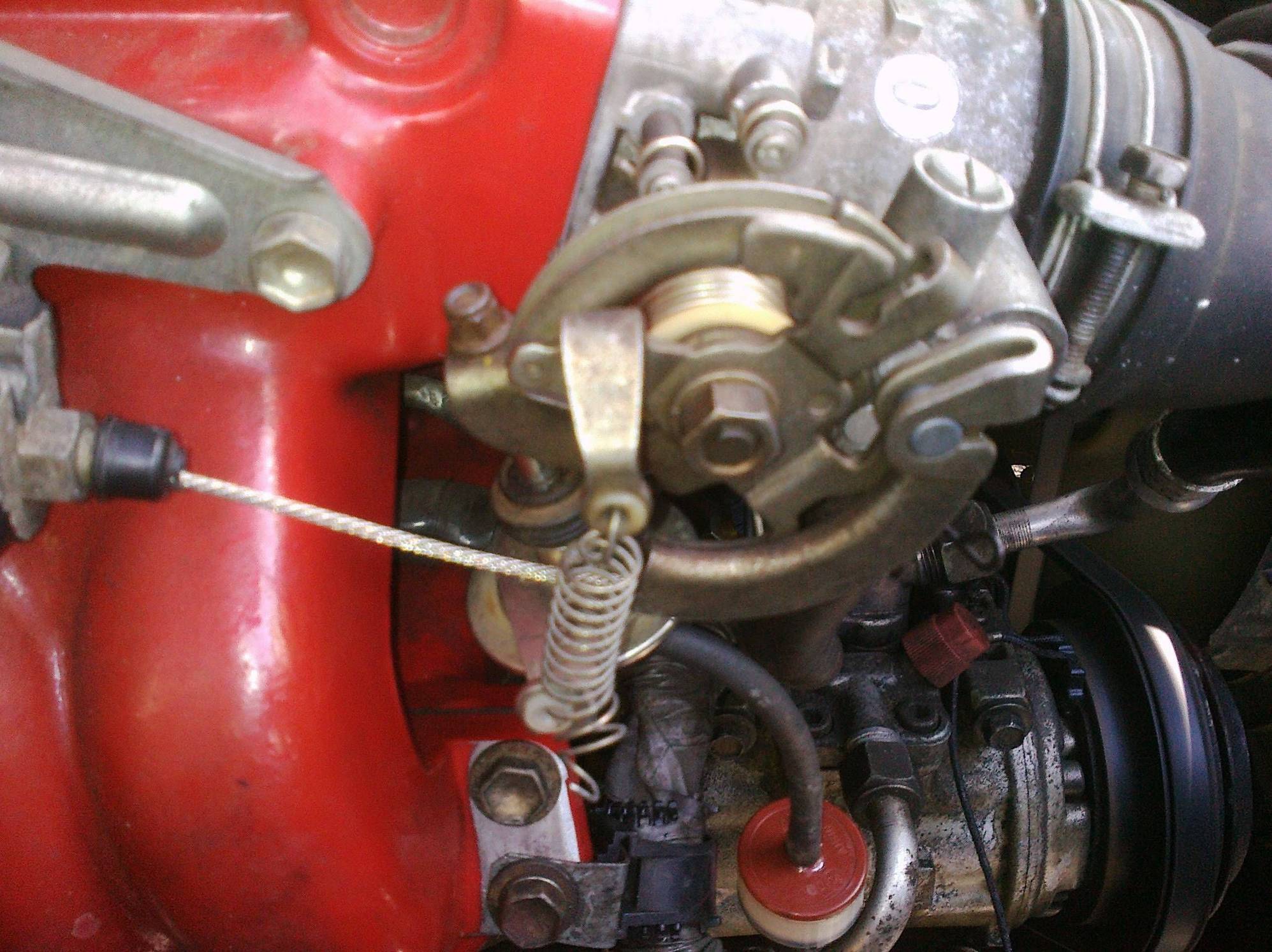

So today was interesting.
I drove it about a half hour, ran perfectly. Then it started acting up: idle starts sticking at 1100, then 1200, then 1400...a pedal tap clears it as usual.
So i stop and open the hood, and I'm making the throttle stick by hand, gently opening it. It looks like it's the dashpot impeding it, but i know the part is new. So, i remove the throttle cable.
I can't duplicate the condition with the cable off. The dashpot slows it as designed, then the throttle closes completely every time.
But there's no bind to this cable. Sliding back n forth from either end, it glides with no snagging.
So i take the return spring off, and feed the twists in two rotations on the bottom, then reclip it to the top. This shortened the spring by about 1/4".
It's pulling the throttle shut Everytime and idling exactly where i set it at 850.
All day since, Everytime. I'm amazed.
Now, only unwanted symptom is low idle when cold, i think to be expected with the coolant bypassed from the Air Valve directly below the TB. I thought that valve idled it up on cold conditions only but I'm not certain of its function.
Either way, high idle mystery seems to be gone. I'm still in shock. Like is this finally over? No more tapping the gas every time i let off? Well i sure as heck hope so. Time will tell.
Here's a pic of what i did: Spring, shortened
you may see the bottom rings kinda bent from the first time i tried this and it didn't help. That was so long ago i don't even know. Years! But it's the missing piece of the puzzle today so I'm calling this fixed for now. Oohrah!

that spring is not stock, but if it works, do it!
