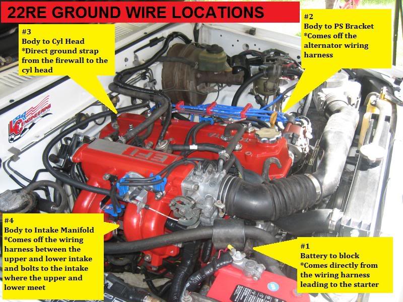

Check the other grounds. Any vacuum leaks? How is the fuel flow? I remove the return line off of the back of the fuel rail and feed it into a jar. It should fill a quart jar in roughly 45 to 90 seconds. Gives you an idea of fuel flow. The crimps to the injectors are a poor design in the harness. I have seen those cause issues as well. Seems like you have covered your bases really well.

I fixed all of those grounds except #4 I have never seen one connected to the intake. But I am not surprised the wiring was a serious hack job that I am sure I will be working on for a while. I also corrected the injector and time switch wiring it was originally jammed in the wiring clip for the starter coming form the battery(I am guessing) because it was hanging over the starter and just not connected. I started up the truck today and there is a noticeable difference in the way she starts and runs...huge smile. thank you for your post it helped and helped confirm that I corrected some issues that needed done
