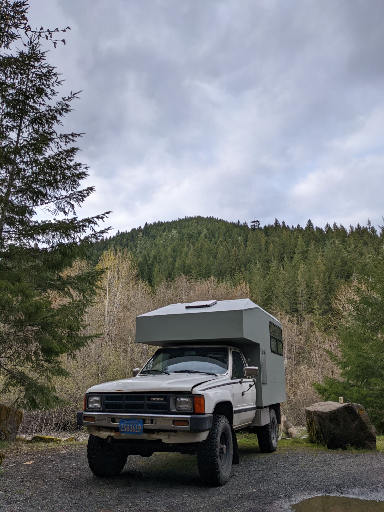

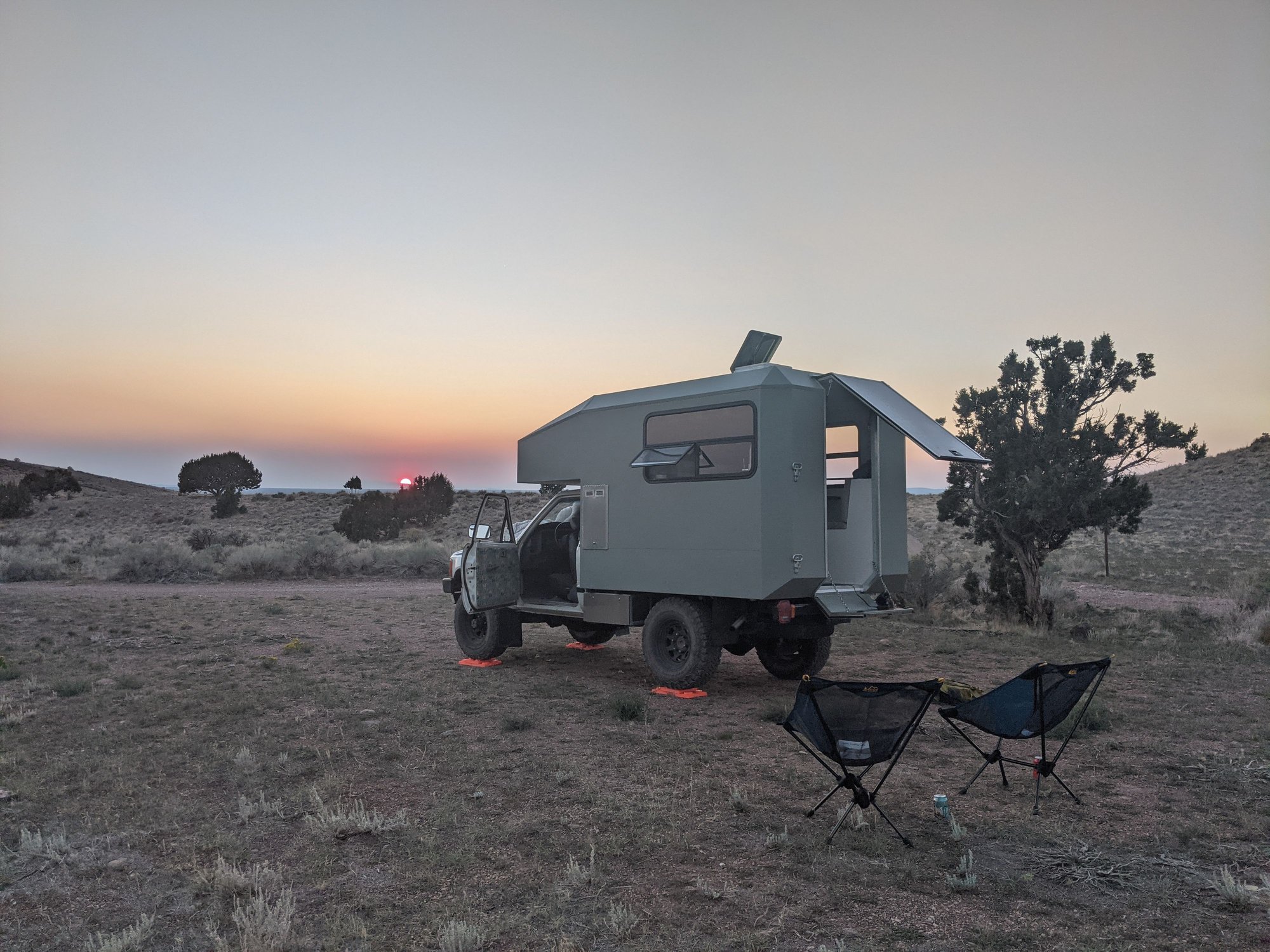

That camper is awesome, can you share some more details? Pictures please!
Old Aug 13, 2022 | 06:26 PM
Branman1's Avatar
Joined: Jul 2022
Posts: 7
Yeah! For sure
Old Aug 13, 2022 | 06:43 PM
Branman1's Avatar
Joined: Jul 2022
Posts: 7
I welded the structure out of light gauge steel. The siding is all glued and riveted 040 aluminum which I painstakingly hand bent with a station bender. Its chassis mounted, spring up front hard in the rear. Nice little kitchen and sitting area, plenty of storage and sleeping over cab. Oh, and 2" xps foam throughout so it stays super comfortable. It's been awesome and I plan on building another one for my tundra next year.
