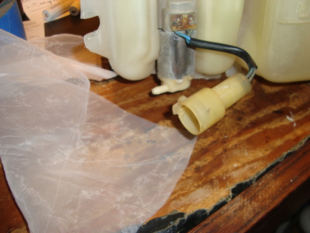

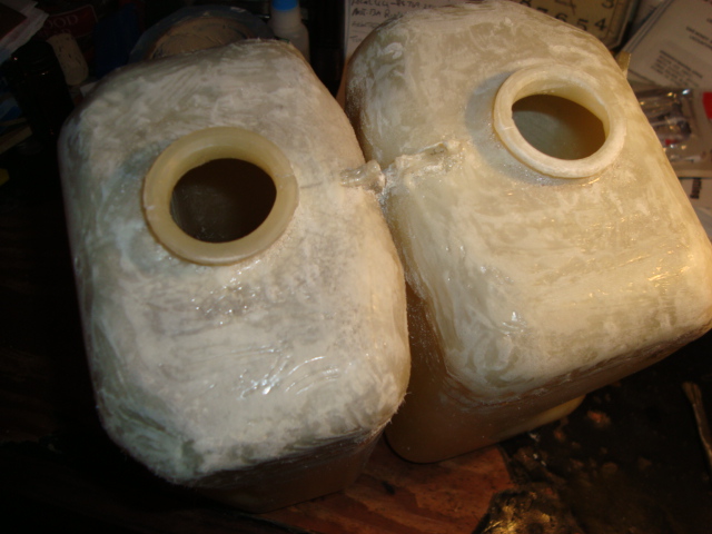

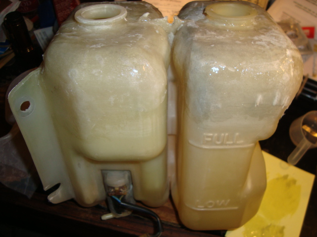

Note; I need to first finish repairing the recovery/washer tanks. They were cracking at top and 1" down so sanded and used a thin layer of regular epoxy to fill cracks then nylon cloth with epoxy gel for a solid cover seal. Was lucky to be able to reach inside to back a hole with tape and the gel works great to fill. Next a sanding and second coat of gel. Looks ok with second sanding and low levels filled with putty knife so no paint needed, good enough for everyday driver

Glad you are progressing. Repairs look good. Me flushed my engine out. Hosepipe in to heater pipe bottom of block top inlet on radiator and top of radiator through cap hole. Two hours later still getting discoloured water out. Lawn is now same colour as dirty water ummmmm see how much grass dies. Filled block through heater hose with front on wheel ramps. Need to get front higher as still got a very small airlock but vast improvement on before. Need another 6-8 inches of height. Jack wont go that high.
