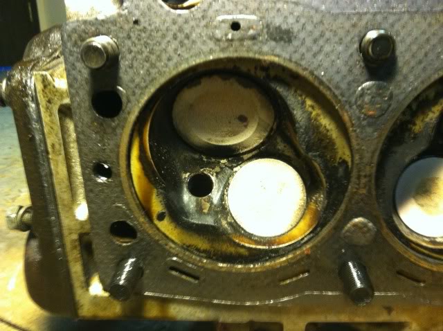

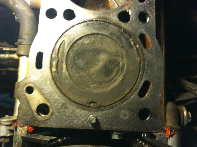

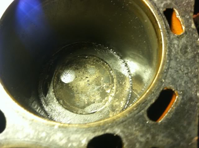

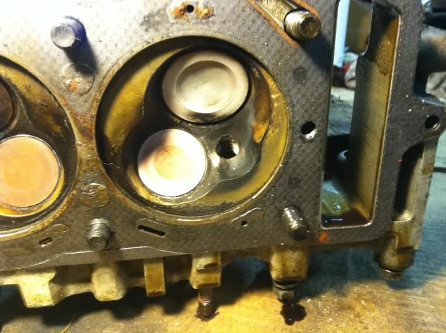

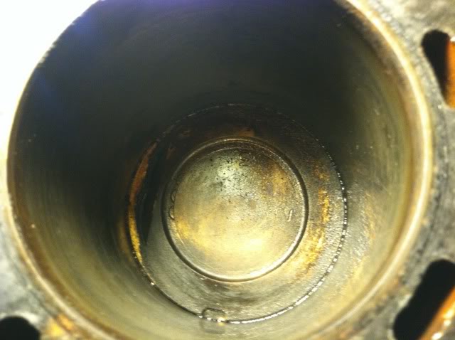

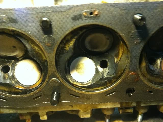

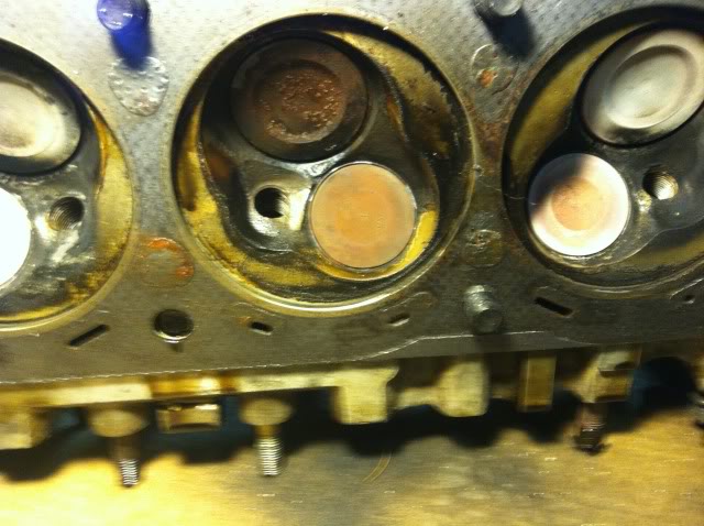

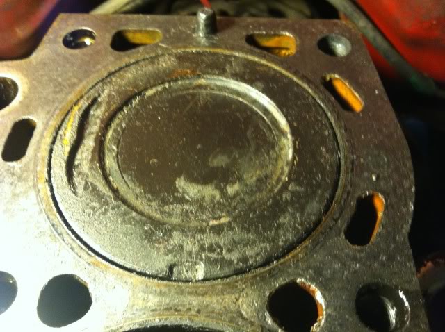

Ok just pulled the head and found badness I think? Weird stuff #2 cylinder valves appear to be rusty, plug has rust on very end of threads.
#4 plug appeared to have build up on it? No real clear spot on the gasket where it went. I started going through water. Not water in the oil or oil in the water.
The filling series's or pictures are front to back 1,2,3,4 for orientation.
Plugs don't look great
Valves
1-4

And cylinders

Suggestions?

What should I do about the rust on the valves?
Old Nov 13, 2013 | 09:04 PM
osv's Avatar
osv
Joined: Jun 2011
Posts: 1,699
Likes: 75
how many miles on the head? was the motor using any oil?
it would probably be a good idea to take the head down to the machine shop and get a valve job on it, also replace the valve stem seals.

Take head to shop for valve job, have it Magna-fluxed and checked for warping while it there.
For a $100 or so its peace of mind to know its 100% when you put it all back together.

Help again. Got it all put back together and she started up great. Let her come up to temp and shut her down. Removed the oil cap and water steam anyways. When I changed my oil before startup is it possible that there was residual water that I didn't get out. After all it was 30 deg out this morning so the oil itself took forever to drain. I am going to get a compression tester and check that out. But assuming that tests ok what else did I do wrong. I so dot want to do this again. Please please please.

I wouldn't be too freaked out yet about water in the oil.
After a HG job there absolutely can be residual moisture in the block that will show up as milkshake under the cap.
Run it for a while and yes do a compression test but don't throw in the towl yet.

Did you thread chase the block for the head bolts?

If their is crud, carbon, rust, grime or anything else down in them you WILL get a false torque reading while tightening the head bolts.
Imagine the difference between tightening a bolt in nice clean threads VS. threads that have rust and garbage all in them. Your wrench will click off on 60 lbs when in reality you only have 20 lbs of force pulling the head down into the block.
I chase them all the way to the bottom which is farther than the bolts actually reach. Blow out with shop air and then use dental pics to scour the bottom of the holes for any stuck debris and blow out again.
The head bolts/studs will then thread in by hand all the way with little to no force. Only then are they acceptable.
