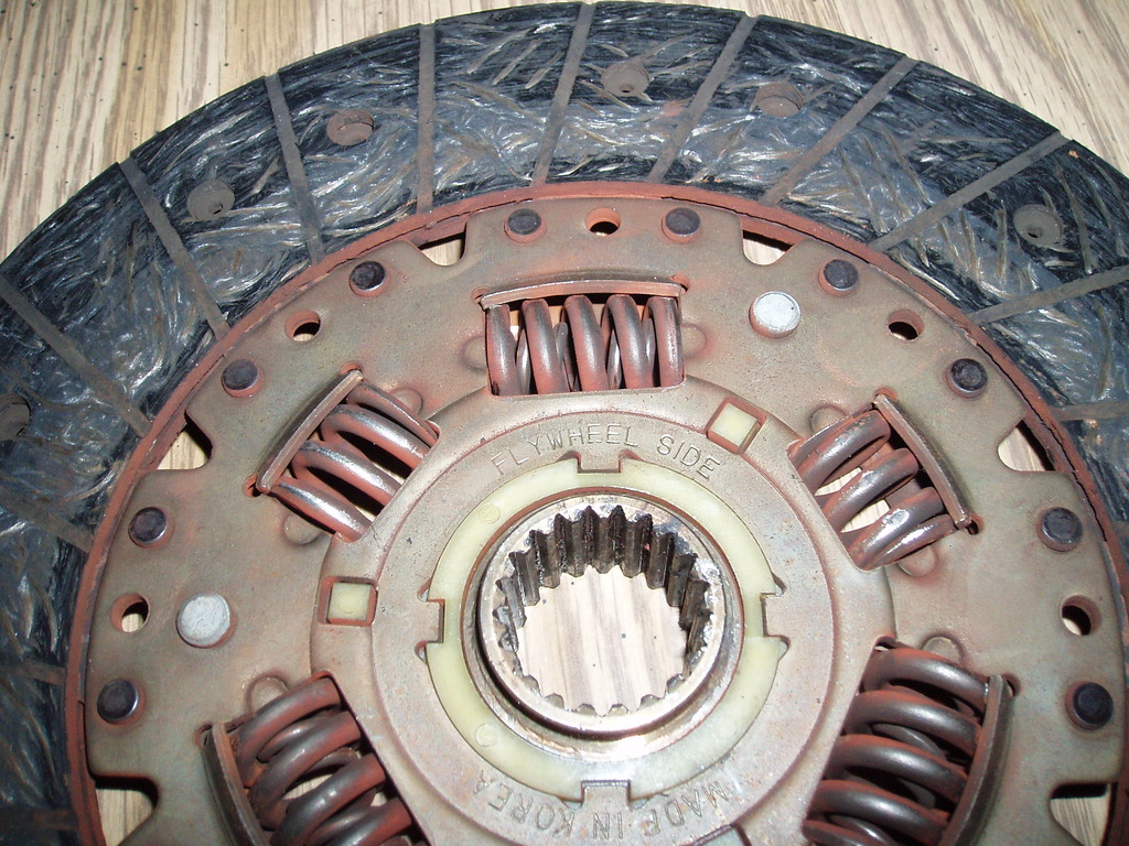

Sorry for the lack of response. The pedal was acting normal, from what I remember. I only noticed the slipping by hearing(and seeing on the tach) it rev up, and not speed up.
I had to replace a pretty much new clutch in my 90 that started slipping and making a metal on metal grinding noise not too long ago. Turned out the PO put the disc in backwards. Which I still don't understand how it held at all. But apparently you can do that and still have it work...for a little while. Like until the springs start contacting the flywheel bolts.

I bought a truck with a bad clutch in it. It too was in backwards. It looked like it was still usable but I was afraid that the springs may have been damaged or compromised and did not want to have to pull the transmission in it again so replaced it.

There's no doubt the springs are damaged in my case.
The real kicker is the words "FLYWHEEL SIDE" on the side of the disk he put facing the pressure plate.
Kinda sad because it looks like a pretty decent non-OEM clutch(Valeo). The pressure plate still looks virtually brand new. But it being non-OEM(also Valeo), I replaced it too. I've got a thing for AISIN clutches you see. No sense wondering if it's a good clutch or not. If it says "AISIN" on the box it's a guaranteed winner.

Oh man! I bet that made a bit of noise!
