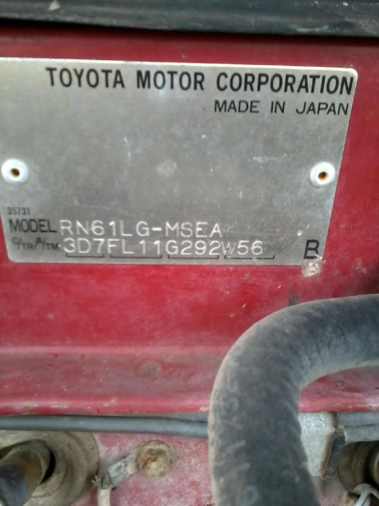

Your paint code should be on a tag on the firewall under the hood. The first digits are the paint code. I personally dont care to see a body color change without changing the color of the engine bay. Just me. To change the entire body color while painting otherwise isnt hard to do. Just got to mask off the interior and paint the jams and inner door assembly while painting all at once.

As for the paint code I've seen that tag you posted. So thank for that I'll check it out. I don't know if I'll end up doing the engine bay or not. The color I have in mind to paint it is the magnetic dark grey that's on a lot of the new toyotas.
